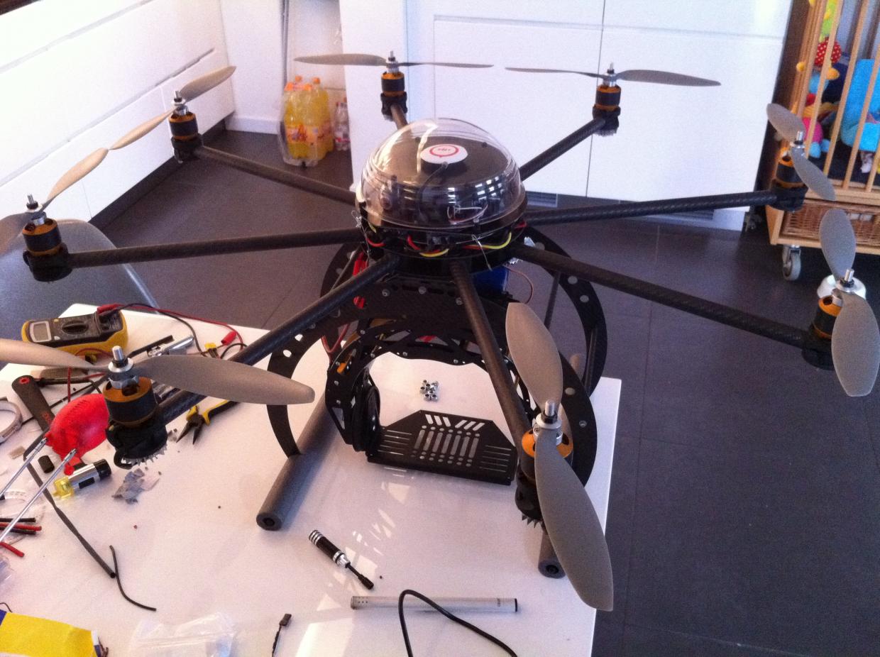

Do we know anything if the GPS module has to be mounted perfectly horizonal level ? Its only indicated that the red arrow has to point forward. Would a slant of lets say 10 degrees massively influence the compass ?
BorisS
quadcopters
i cant see a slight slant making any difference really, I have mounted antenna on top of the lid and no need to cut holes .. the cable will fit where the canopy sits over the legs .
I also put copper tape on the inside of the lid and cold boot time was less than 2 mins.
BorisS
Thanks !, okay i am going to stick with the slight slant also dont think its a prob. I wonder if the little module on the GPS cable has any other purpose than splitting the or hubbing the canbus signal. I would really like to get rid of it.
Boris
BorisS
Took it up today for the first tests two small 1800 mahs 4s and i am getting a strong drift backwards. Bird is leveling out and i drifts back.
TX is configured correctly.
Mount IMU is correct.
Gains are okay steady go in the air as long as i manually trim it.
Any ideas what else it could be ? Shouldnt it be working against this drift by its own ?
