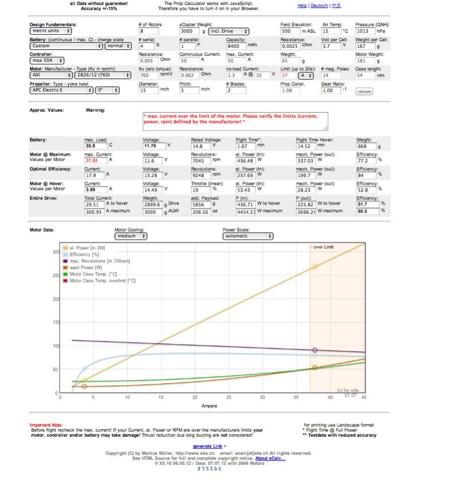

Using Ecalc it tells me that 15x5 prop and a 4s will me over the max current of a 2826-12.
With a 4s max prop size: 14x5
With a 5s:12x5
With a 6s:11x5
Am I doing something wrong?
With a 5s:12x5
With a 6s:11x5
15x5 props are huge. What is your AUW? For example my octo lifts 9 kilos with ease on 4S 14x4.
A nice prop for the AXI 2826/12 is a foxtech carbon 13x4 on 4S. If you need to lift big or swing 15 inch props get the extremely heavy AXI 4120.

I only have 4s lipos at the moment but Plettenberg does not recommend running the Orbit 15-20 on 5s with 14x4 props.
Your ecalc testing seems correct the 15x5 are too big. Large props need low kv motors and high cell count.
