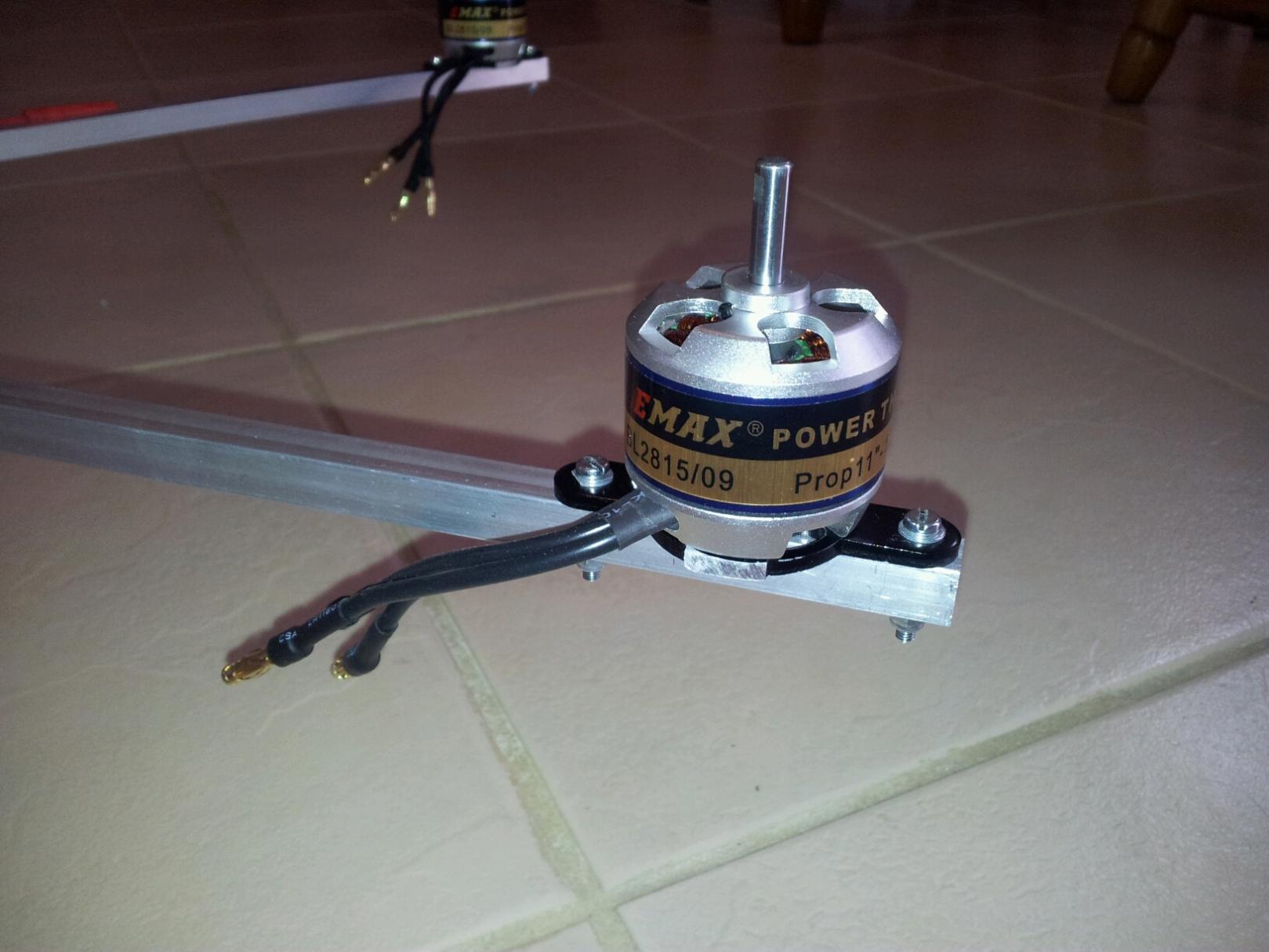

I took a real flight today. It's pretty stable and needs some tuning. I was afraid to kick it around too much because I need to strengthen my motor arms at the clamps.
