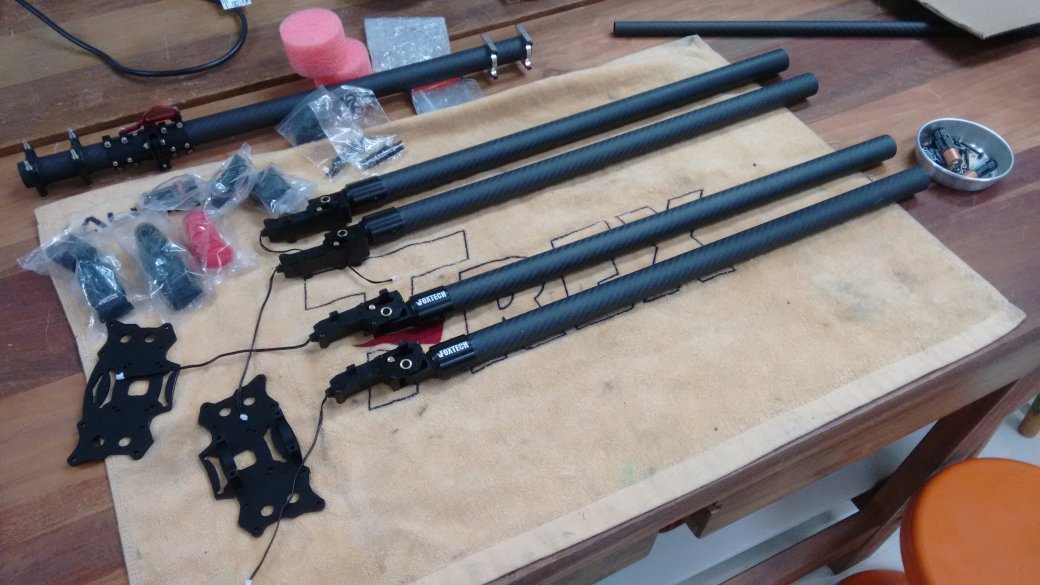

View attachment 26156 I use a 1448 on the top prop and a 1555 on the bottom prop All using SS V3508-29 380kV Motors. Good handling and powerful yaw characteristics. The vertical take off is tremendous. Check this link on youtube about efficeincy..very interesting.
