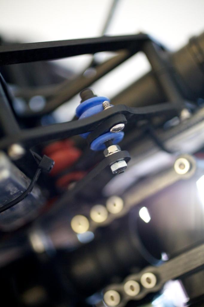

Hi,
I have both Radians in Cinestar gimbal and Skyline in AV130 and i have to say that currently i get very similar results with both systems. Radians works well but biggest problem for me has been bouncing roll axis with cinestar gimbal. I had to remove original Cinestar vibration dampenings and i have rebuilt new dampening mechanism and it's bit better now. Skyline AV130 combo in my Y6 hexa works very well at the moment. No jitters, no drifting horizon etc. but setting it up is bit more complicated than radians. One advantage for skyline is that if you are using system as one man setup you have possibility to adjust gimbal tilting in proportional mode in tx but radians allows only slew mode. And other thing is price, is radians worth 3X price of skyline, i don't know.

PaNt
Hmm you removed the stock dampers...?? isnt there a way to put both???
And when you say it better its a lot better??
Kari
I don't think you can put them both, and i think it would be too hard. There are different softness options in these ball dampers. It's hard to say how much better it is now, still no perfect but best i've tried so far.
PaNt
Freefly has some new dampers :) :)
