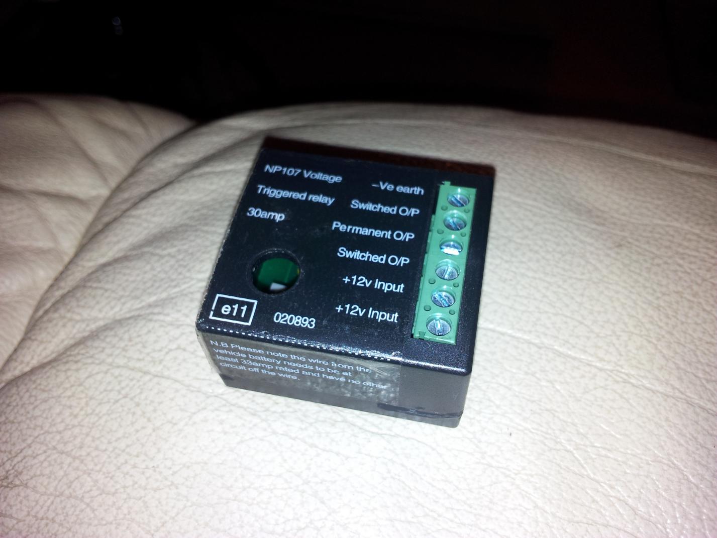

You want somthing like this Gunter, cheap and easy to install. I fit hundreads of them, they work well.View attachment 3407
