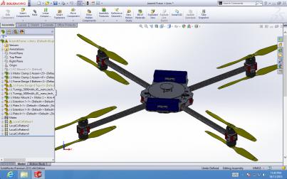

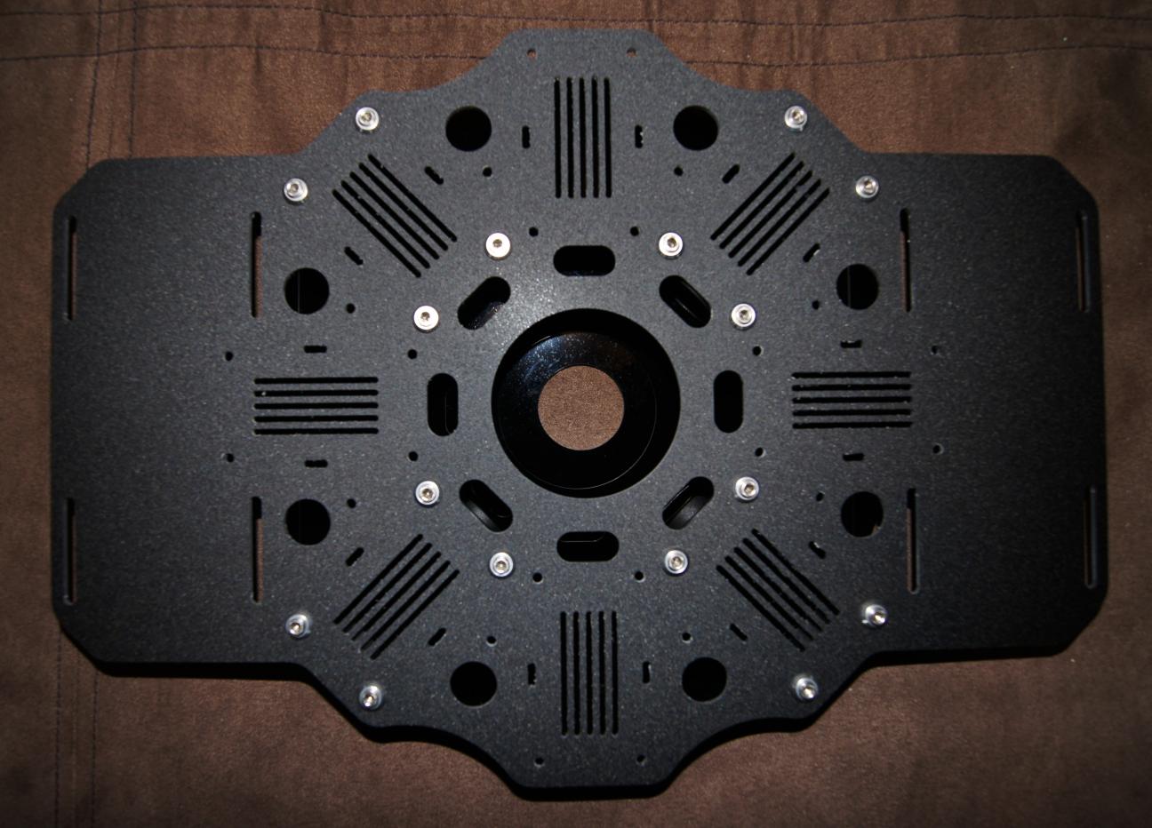

New update, you can call it Design "5s" :nevreness:
New location for battery that previously wasn't available. Those are 5000mah 4s size.
Holes slotted so that two straps per battery can be used to securely hold it down.
This does not affect if its a X8 or octa configuration, as the batteries are above the carbon tubes.
View attachment 13959View attachment 13960View attachment 13961

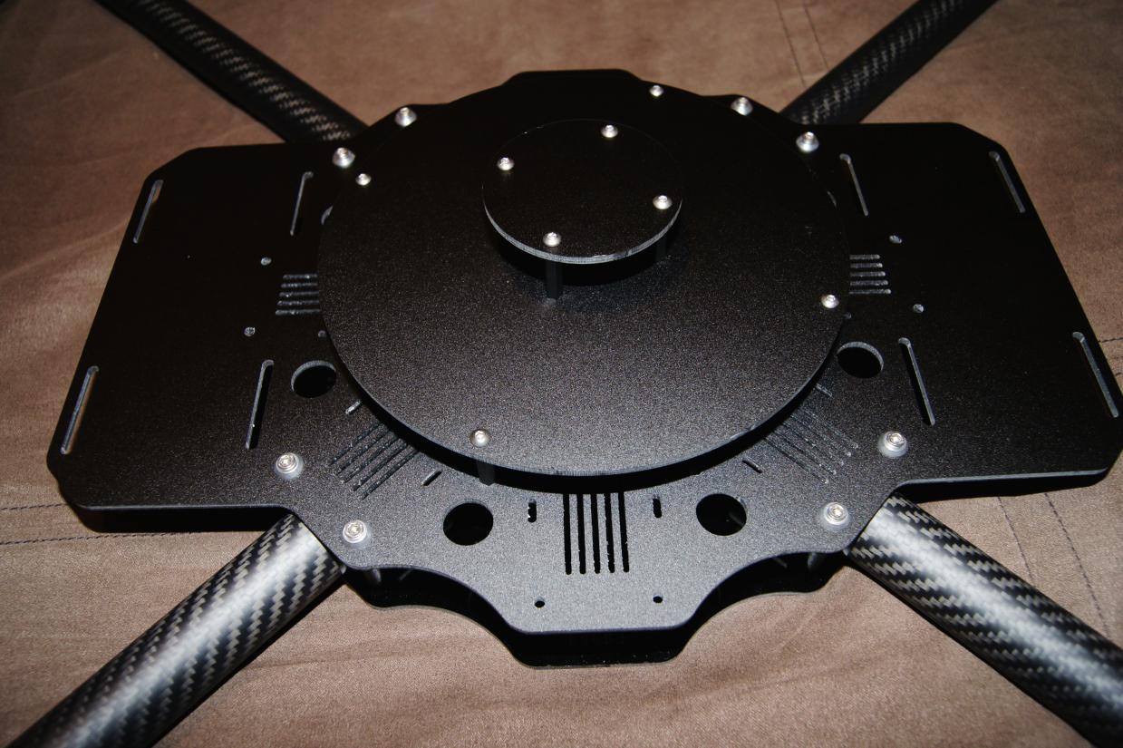

Bruno28
Acrylic center for final Prototype V1.
Full carbon fibre arms + stainless steel nuts and bolts
Level 2 and 3 not yet installed for FC and GPS.

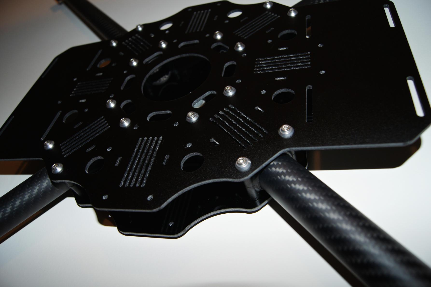

Bruno28
SO now i have added the 2nd and 3rd lever for GPS and Flight controller :)
