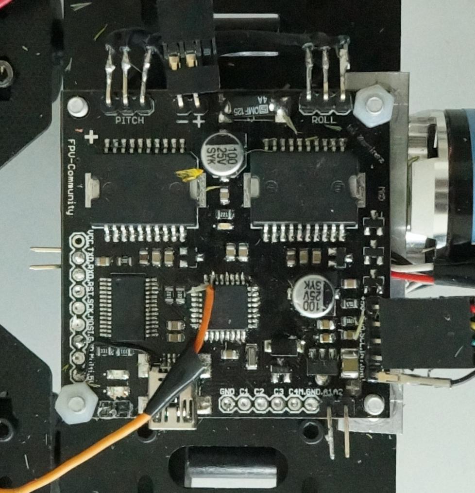

First things first, the brushless gimbal is about the simplest thing mechanically to make work, it's a basic L bracket with an awesome board. As long as you can balance the camera the board will handle the rest. 99% of the gimbals dont let you balance the roll axis so in this regard the Musky gimbal lets you adjust tray height so it wins there. The Martinez board it comes with is a good board but most would argue the Alex board is better and the Alex GUI is without comparison. If theres any longevity to Muskys gimbal it REALLY should be sold with the Alex board. I have an Alex board but remains to be seen if I'll use it on this project.
