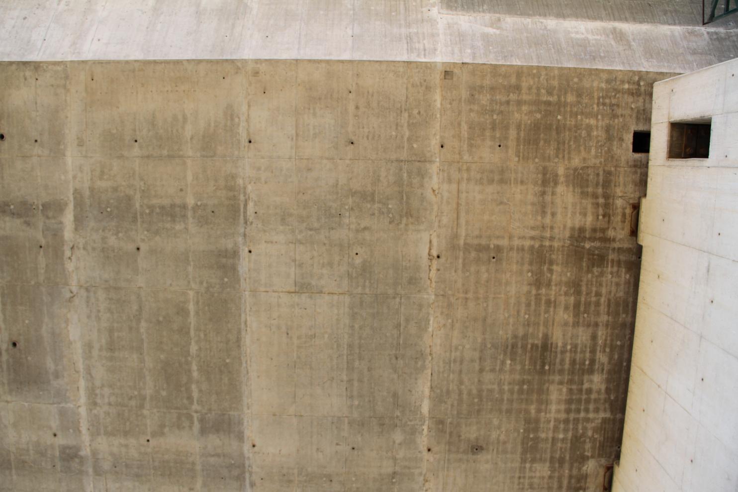

For me, video is not the way to do inspections on bridges or on any other structures. Its ok for a first look, but if you want to really see whats going on, you must have pictures, High res pictures and not pictures from "sports cams". Also forget the Sony 780/790 and look alike. its a very good camera its a 24 megapixel sensor, i have one. But its better to have a full size sensor or a APS-C with lower resolution to take pictures.
Second; for bridges, you must have a UAV that can "look up" and as Buzz_Roavr said... you have the falcon 8 UAV
Third... there is no way of you do a inspection on a bridge if you don´t have flight skills. Bridge are the worst structures to work. You have the turbulence, you may fly very stable, and 1 meeter to the left you may have strong winds. And you may have problems with all the iron and cables inside the bridge. They may affect the compass.
But, UAV are the way to do it most of the times with very good results.

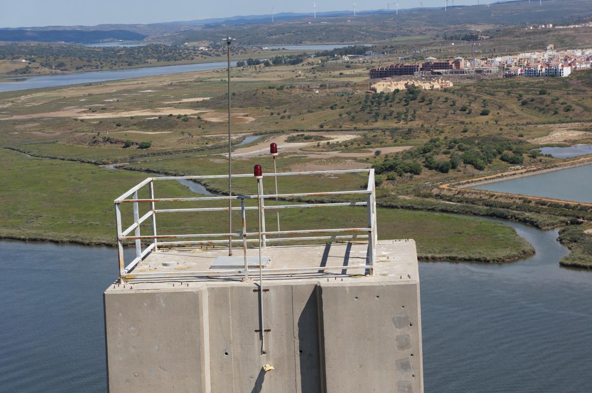

This bridge is 108 meters high from water level to the top
attachment.php
As see under the bridge
attachment.php
At the top
attachment.php
For this bridge were taken 2750 Photos
