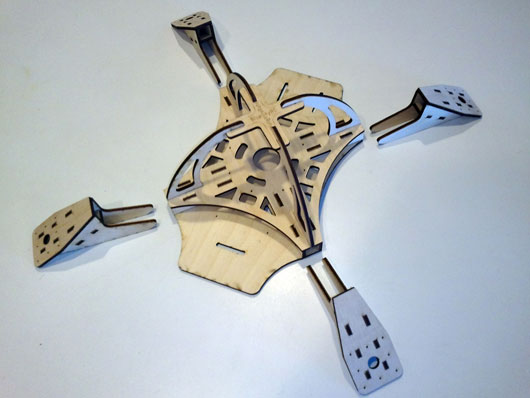

HI Guys
I have just recieved one of these FPV Quad kits from BlueSky RC and I need some recommendations for Motors
http://www.blueskyrc.com/index.php?..._id=21&zenid=06c0c0b82fe5eca515d19e7bab164343
What a great Price!
I will start out with the Gaui 8 inch props but i would like to be able to spin 10 inch props if the desire to do so takes me.
I always struggle with motor prop combinations so would like some recommendations please.
I plan to fly with either 2200 or 4400 3s packs
I have 25amp esc's
I was thinking about these RC timer 2830 1000kv motors
http://www.rctimer.com/index.php?gOo=goods_details.dwt&goodsid=554&productname=
Would they be suitable for both 8 and 10 inch props? I am happy to stick with 8 inch if it makes the decision easier was just thinking of some extra flexibilty.
Or should I go for lower KV 850-750??
Thanks in advance
Ben
