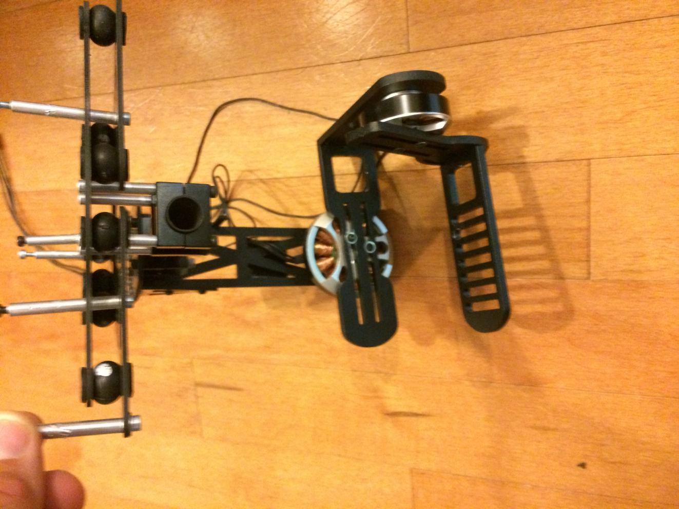

I don't agree at all, I have several 'One side supported Gimbals' and all of them works great, but of course are not made in China ;-)
What size are the motors you are using.
The first gimbal I had had crap motors and was simply a turd and got smashed.
The second I still have, and it seems like it could work, but it seems to get shakes in long forward flight. The rig is properly balanced, and the props are spot on.
The gimbal has a Ipower 5206 on the roll and a 4006 on the pitch. No matter how smooth the tuning and how perfectly the gimbal worked on the ground it had the flight twitch.
If anyone wants to try it, I’ll sell it for $275 +$10 shipping in the US.
Let me know.

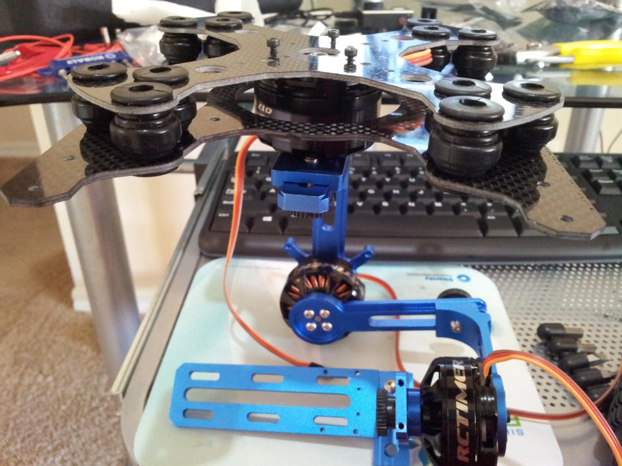

remvideo
I have the RCTIMER 3 axis "asp" gimbal and it functions very nicely, it was $350 and included the alex-mos three axis board.
