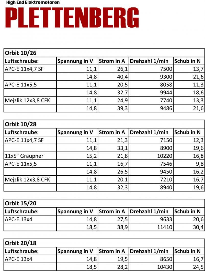

The thing I don't get is why the Plettenberg motors use collet style prop adaptors, I'd much rather a bolt-on style like all of the other heavy lift/high end motors. To me, making a high end hand built motor and then using a slide on collet adaptor makes no sense and actually seems like cheaping out on the accessories.
Ken
You can get them with a custom integrated prop adaptor with a helicoil nut like the pic I posted a few posts back.
160 grams with no cables
are the motors held together by the four little screws at the top of the motor's bell? maybe Plettenburg could take a basic Tiger motor and wrap/balance it to their specs? that would seem to be a winner. :)
I usually get 10-12 min with 2 4S 8000mah on my Skyjib 8 of 7700grams AUW. Everything is cold to the touch even at 30C ambient.
