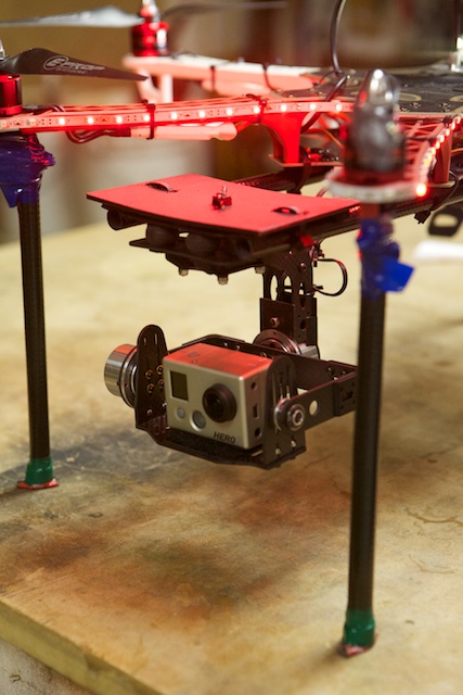

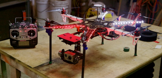

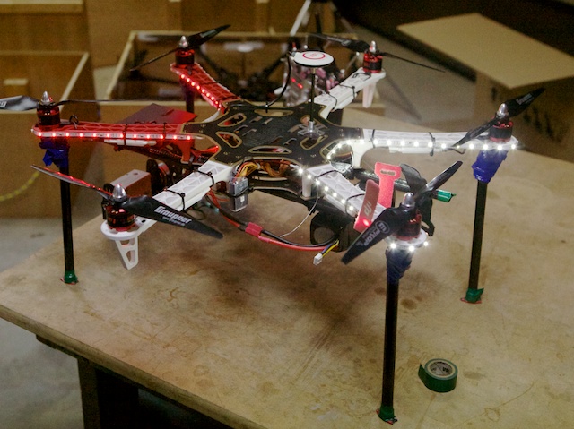

Here is my simple leg solution and my Yun-1 gimbal. This works very well and is light.
I use 3/8" carbon rods for the legs and rods to hold Lipo and Yun-1 gimbal. Not as good as a Zenmuse but only $400.00 for the gimbal.
View attachment 11981View attachment 11982View attachment 11983
Here is my first test flight with this rig:
It was a bit windy and my garden is a bit tight to fly in but for a $400 gimbal this is not bad.
