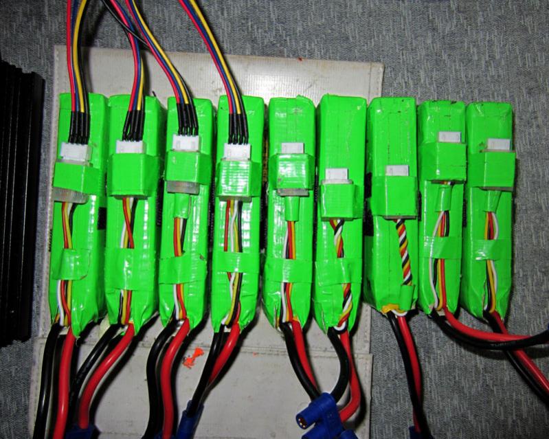

I had Genace and then bought some Zippy Compacts... the Zips performed the same and weigh less so i sold the Gens.
During a cartwheel incident a balance lead flung out and got chopped or crushed dunno but it smoked for a sec and had to be replaced.
Also got tired of always having to tuck in the balance leads when mounting... so now i put on a jst saver and tape them to the batt... better for charging as well.
