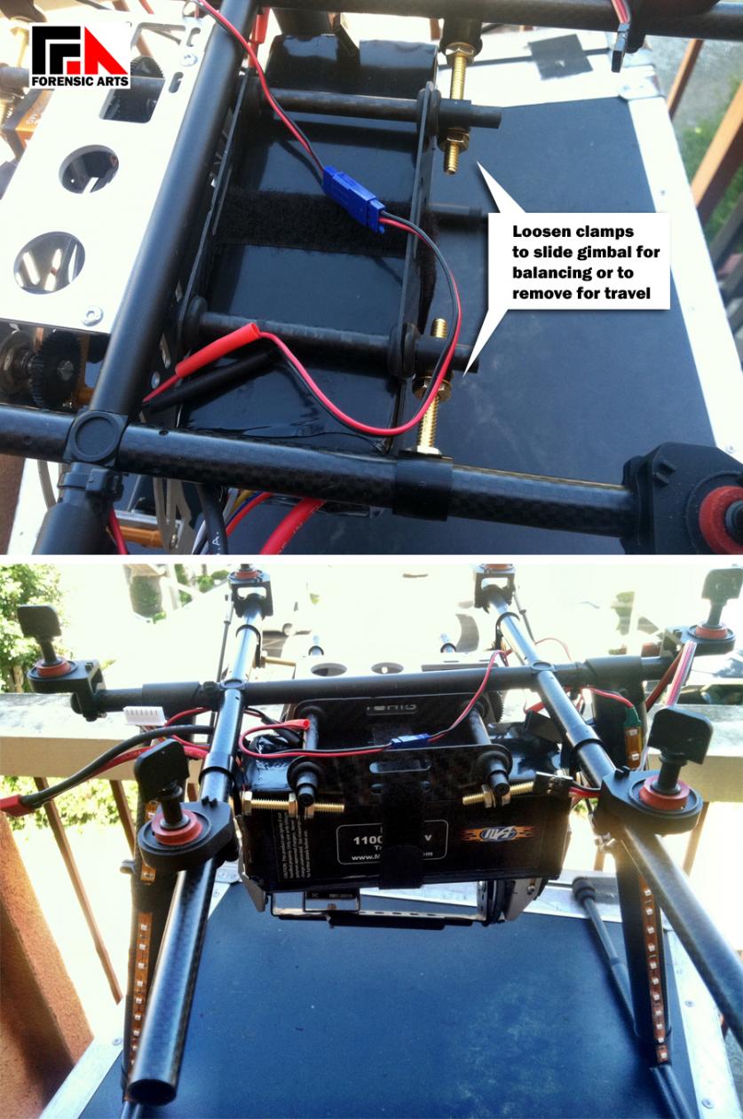

Well, though I don't have the battery tray yet (let alone the Zenmuse), I've got to take this S800 on the road so it can start paying for itself. I've got a forensic shoot in Nevada tomorrow so I'm going to take it on its first road trip. Thus, I went by FRY's and got a couple plastic mounts and then stopped by OSH where I picked up some #10 brass bolts/washers/nuts. The bigger plastic mounts fit on the S800 landing gear horizontal bars and the smaller clips fit on the smaller carbon rods from the Droidworx mount for the AV130. It also has the Droidworx battery holder, which works really well to hold the 6S Maxamps 11000 batteries that I'm using. By untightening the screws I can slide the whole mount to balance it and, of course, the whole thing slides off easily for portability.

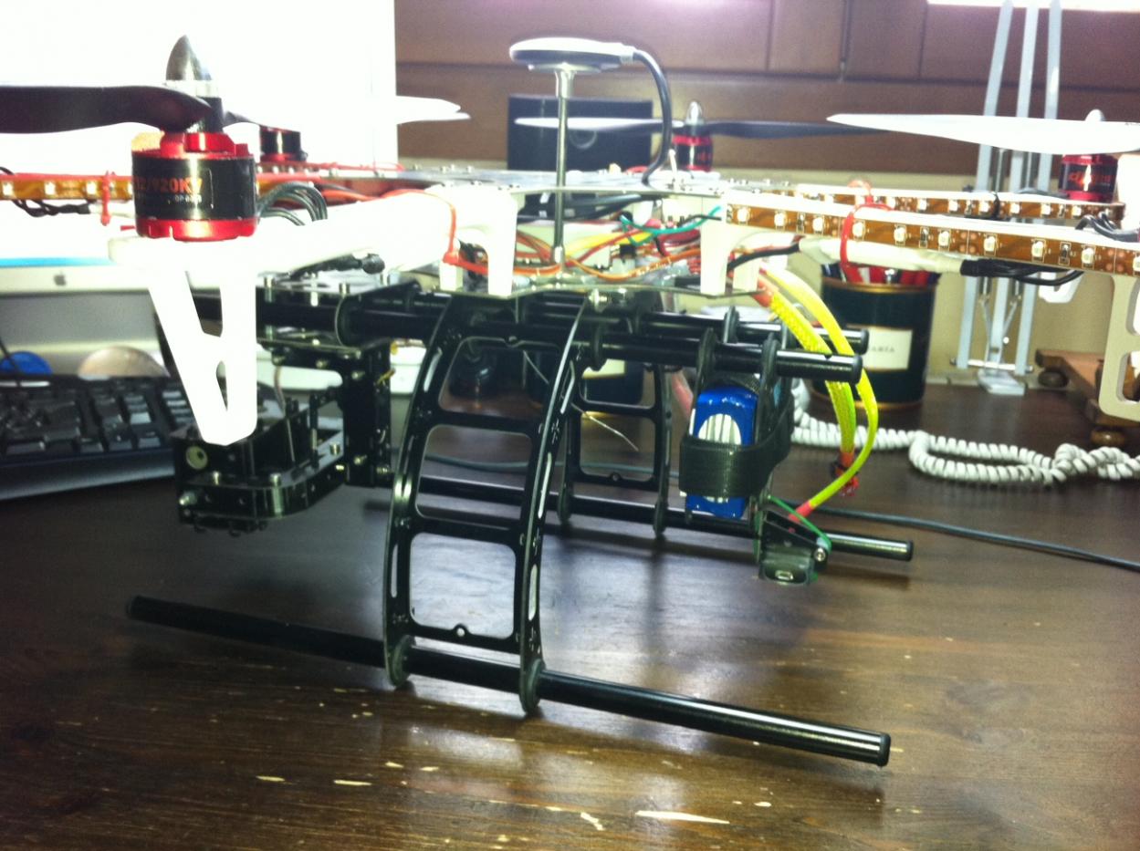

This is how I mounted mine until my Z15 comes.

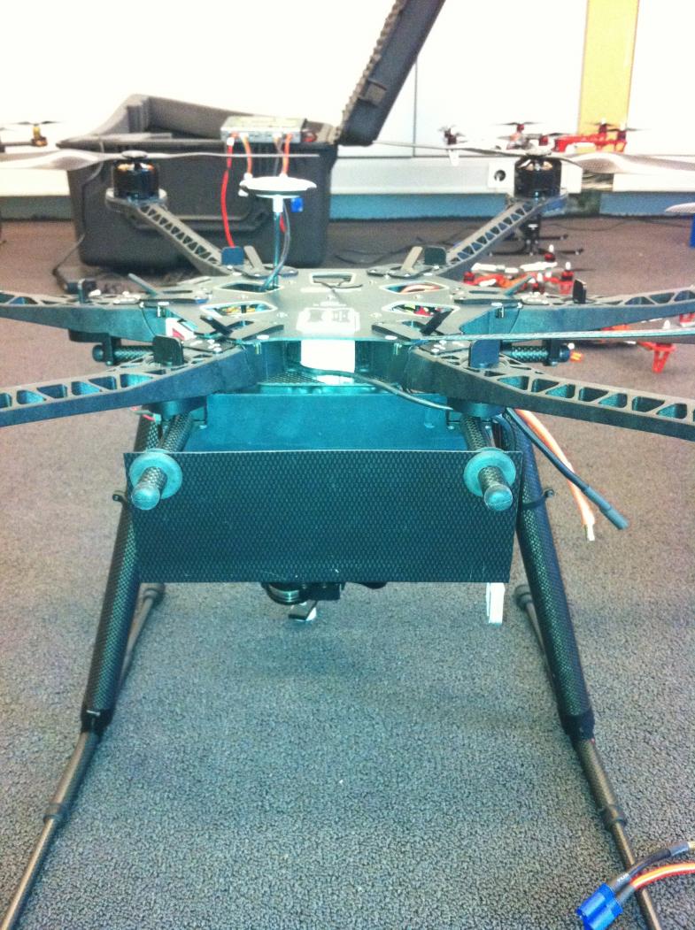

we are lasercutting ABS lipo holders for the S800 as we speak , simple , deadcheap , and you can slide them forth and back to get the perfect cg
they are made of ABS carbon lookView attachment 4857
this one holds a Max amps 11000 or 6S 8000 mah
we can make to size if needed
