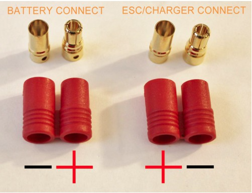

I found these to be AWESOME.
Secure lock, easy to soldier big wires, and can take a solid 200A with no issues.
PRC6 Connectors
Ideal for heavy-duty applications requiring up to 200 amps of current and 8 AWG wire - untinned; pre-tinned wire can be tight - these are some of the largest shrouded connectors available, combining safety and performance. To simplify your charging setup, these connectors are available in red and blue - we recommend using one color for your batteries and the other for your ESC and charge cables, so that you know you're always making the right connection.
If you are lifting a Buick they also make the PRC8
deal for heavy-duty applications requiring up to 300 amps of current, and able to easily handle 6 AWG wire, these are the largest shrouded connectors available, combining safety and high performance.
