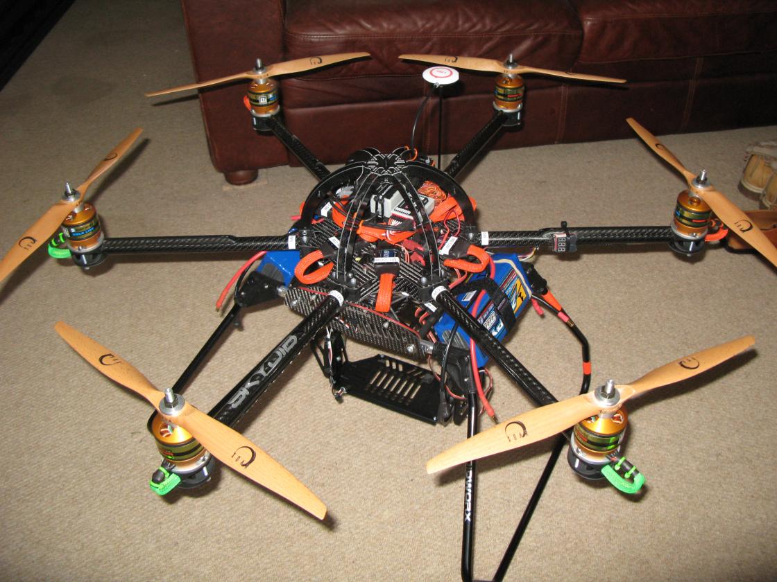

my MR set up is:
Skyjib 6,
Axi 4120 motors,
15 x 4 beech props,
Dji wookong fc,
80a esc,
Av 200,
360 pan (fixed solid at moment, waiting for PH stabiliser)
The props are new and have not been balanced by me since purchase,
How do I balance props?
Also, how can I make sure the motors are all straight and vertical?
Regards all david

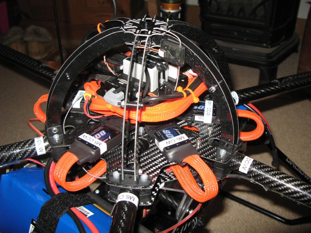

hi all,
thank you for all your input... i am working my way through the list of causes... just confirm, my 360 is disconected and cable tied rigid.
i have attached 3 x photos of the build up, i have not got the dslr on there at moment becaused i plan to take off the tilt belt to balance the camera on it perfect....
i have just balanced all my props, 2 x blades lightly out and 2 x hubs medium out, they have been done now, but its too wind to test it at moment.... as soon as i have, i will post another video...
