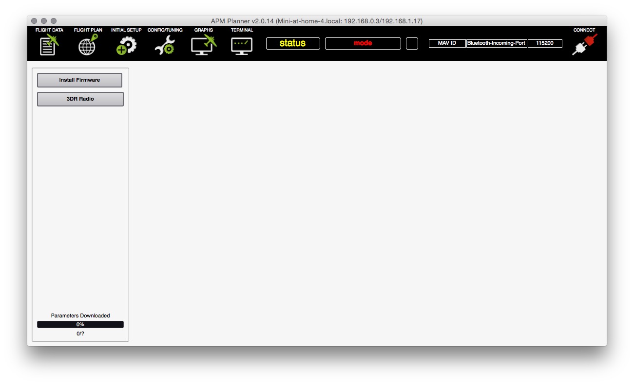

I have connected my pixhawk for the first time to a Mac and ran APM 2.0 to set it up. After loading firmware successfully, I think, there are no further options to move further.
The Ardupilot page describes how you can then select 'Mandatory hardware > frame type and so on. I see nothing. Just 2 buttons - Install firmware (already done) and '3DR Radio.
Is the OSX version missing something OR do I need to have the whole system wired up. I currently have the Pixhawk only wired into the USB. Does it need all the ESCs and motors connected to open up the configuration options?
Otherwise I'm guessing it may be PC only but it's not mentioned in the set up as far as I can tell.

I have encountered similar problems while trying to setup an APM 2.6 board. Here is what I have figured out...
First off, there are two software packages. One is "Mission Planner" and the other is "APM 2.0". I think the link that PhillNZ posted applies primarily to "Mission Planner", not to "APM 2.0".
Mission Planner runs only under windows.
APM 2.0 will run on Mac or windows.
It appears that the Mac version is limited as of yet. It might be that APM 2.0 on the Mac can be used in a run-time mode, that is, once the aircraft is setup and flying. It also appears as if the windows version is required to do the basic firmware installation and setup/calibration. When I plugged my APM 2.6 board into a Mac, I got the two buttons that you described
As for connecting, I was able to do basic configuration (choosing aircraft type, reading GPS position, etc) by connecting just the APM board to the computer (windows) using "Mission Planner". In order to do any more calibration of the sensors, I think that the whole thing should be installed into an aircraft. Once I had done the basic configuration done, I plugged the APM board into a couple of Macs and they all recognized the board and seemed to connect correctly using APM 2.0(which is why I suspect that "APM 2.0" may work as runtime on a Mac.)

You need to click the Connect icon in the toolbar to establish a connection to your Pixhawk first. Then you can get to the options you're looking for.
