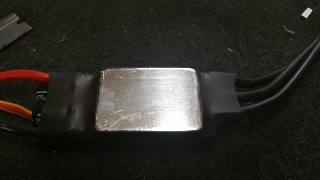

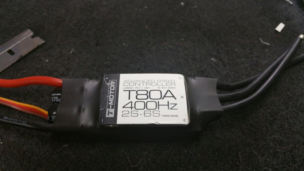

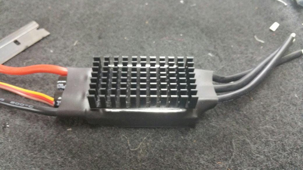

Here's what i did with mine. I added 25x50x10mm heat sinks. I also have 25mm fans that i will add if I'm not happy with heat dissipation.
Use a razor to remove heat sink tubing off aluminum heat sink.
You'll be able to pry the stock heat sink off easy. Use a fingernail to pry up.
Roll back the "puddy", then sand to help adhesive grab and clean with alcohol. Also clean 3 copper bars on the board with alcohol.
I then mixed up a tiny bit of thermally conductive, electrically insulated adhesive and put a tiny strip on each copper bar. (forgot to take picture)
I then stuck to back on and applied pressure with a spring loaded clamp. I had a big clamp so I was able to clamp all 6 at once.
Then I stuck the aftermarket heat sink using its own very thin adhesive backed sticker.
