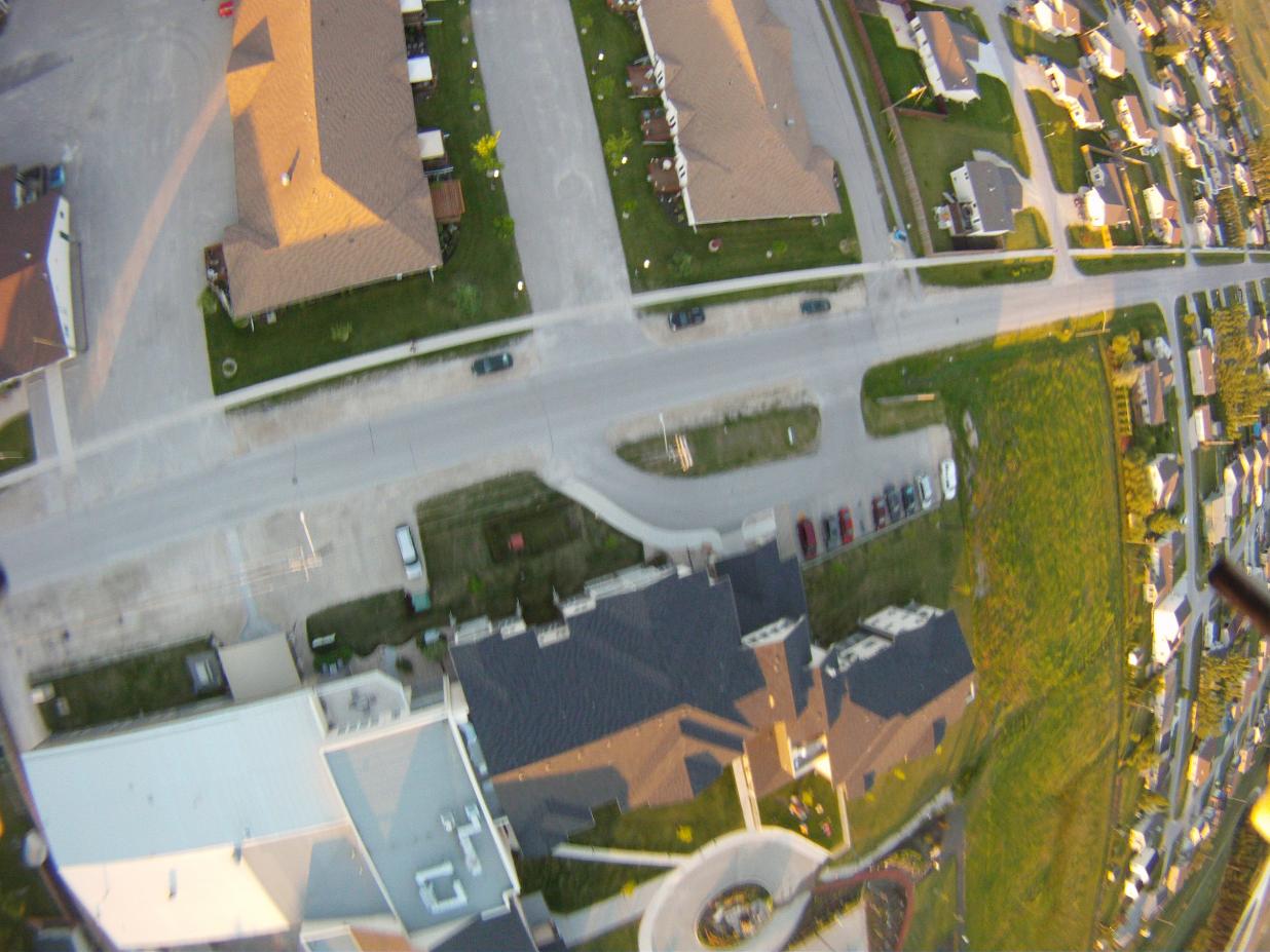

I had a very bad crash a few weeks ago. I have a ADL 6. The flight started out like any other, I was flying in manual taking some shots with my gopro. About 2-3 minutes into the flight and about 60ft high and 150-200ft away I decided to bring it back. At that point as I pulled back it sped up and I lost control. After a long loop from east to south I decided to turn the gps on and see if I could bring it home. I guess I wasn't patient enough and it was just too far away to see what it was doing. That was it. I managed to find it over 1/2 mile away...very badly damaged. Any insight. One question if I would have let it come home would it have come back to where I started it? Shaun
baker55
here is just before and just after I lost control.
