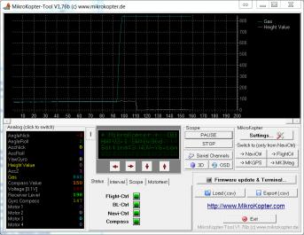

When connected to MKtools the graph is showing movement (altitude) so im assuming it is working (see screen shots (before and after transmitter is on) and also moving the MK up and down gives a reading.

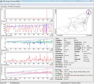

Looking at the pressure sensor itself, soldering loosk ok no cracks etc..... I have attached a screen shot of the gpx and it show nothing at all for ALT??

will check that tonight, what sort of odd can I expect? as in "cut in and out" in scope? or big changes in height?
MikroJ
Ok here is the result, seems to be consistent and not drop out ? Does anyone know the default number for altitude settings? maybe going back to factory default or at least see if Im at default figures? But I still have the concern of no data recorded on my sd card for height?? I have reformatted to see if that helps, no difference everything else is recorded just no height?

I have a very similar thing going on. It will usually show the elevation but it is WAY out and not very accurate at all, I also sometimes get the flat line reading 0 the same as you. I noticed this before upgrading to the latest firmware and it still does the same thing now.
I have tried different FC and Navi boards but it is the same. I guess the only thing left is the SD card??

OKAY some success, I know get altitude hold working (needs little tuning) and also a reading in GPX, What I did to get that not too sure .....But i can tell you what I changed , here goes........
1. Removed sd card and reformatted using Fat16, default size allocation.
2. Re installed the 0.26 navi firmware with sd card in.
3. Mktools - altitude - changed Min gas from 100 to 30, increased z-acc to 4 (did some reading else where got some tips) changed max altitude to 0.
4. Mktools - easy setup - changed stick neutral point back from 127 to 0.

Max Altitude to 0??
For the logging, I'm guessing it would be the re-formatting of the SD that helped, I have tried all the others and it didn't make any difference for me anyway.
