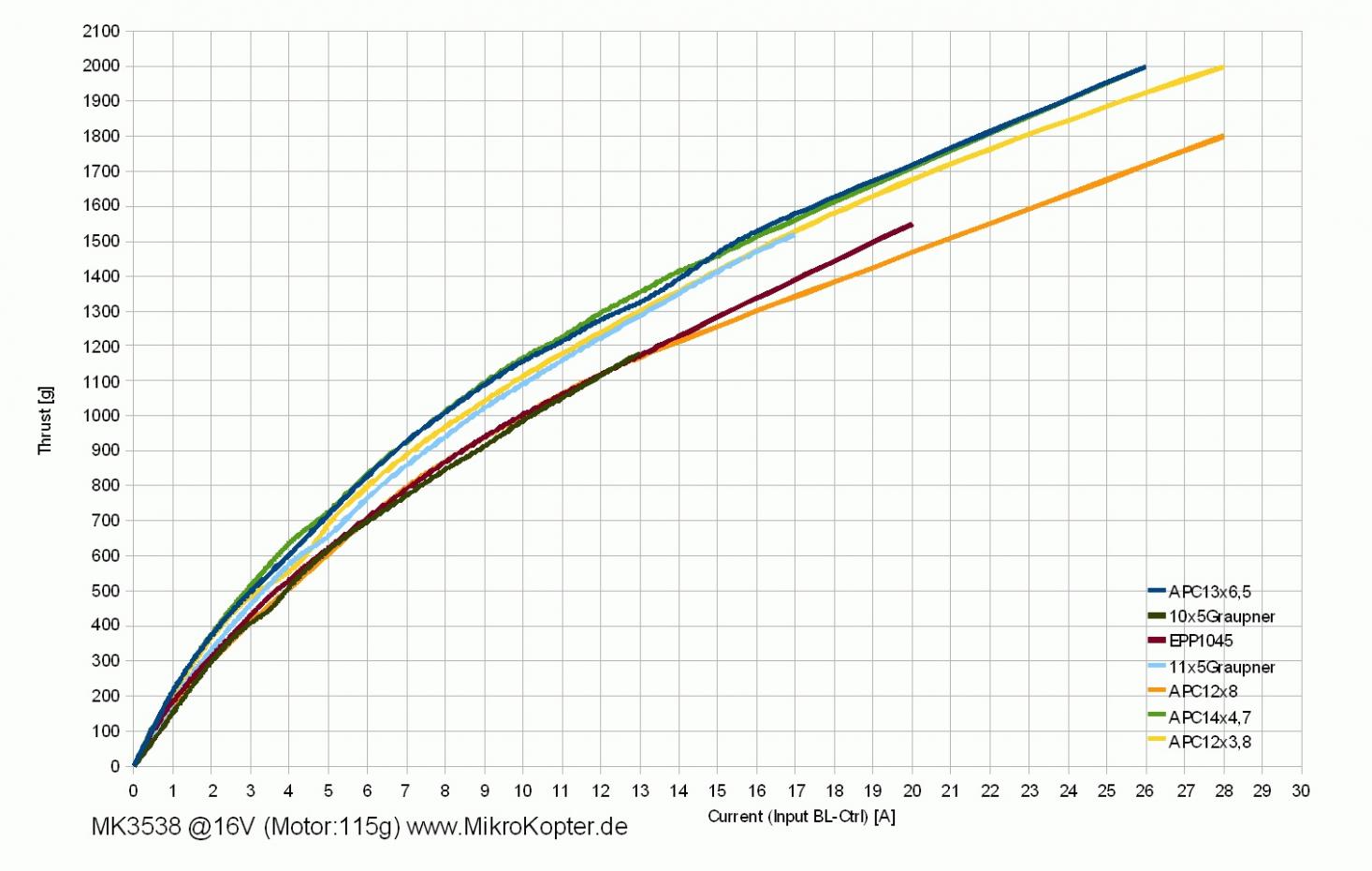

On an okto using BL 1,2 you have in theory a total of 80A continuous and 160A peak, with a 4kg okto I am hovering using 35A with roxxy's, so half of what the system can handle.
My theory is bigger motors, bigger blades, a little extra weight. I will probably end up using around 25A-30A, The avroto is similar to the pulso & mk3635, which If you look the amps per grams of thrust on the chart on the mk.de website, A 4kg okto will use 24A to hover.
So why change to the BL 2.0 when you will be drawing less the 5A per controller and the BL 1,2 can do 10A continuous!
The only thing I will change is max throttle, because the peak amps of the motors is over 20A and will fry the BL 1,2 ESC at full throttle.
