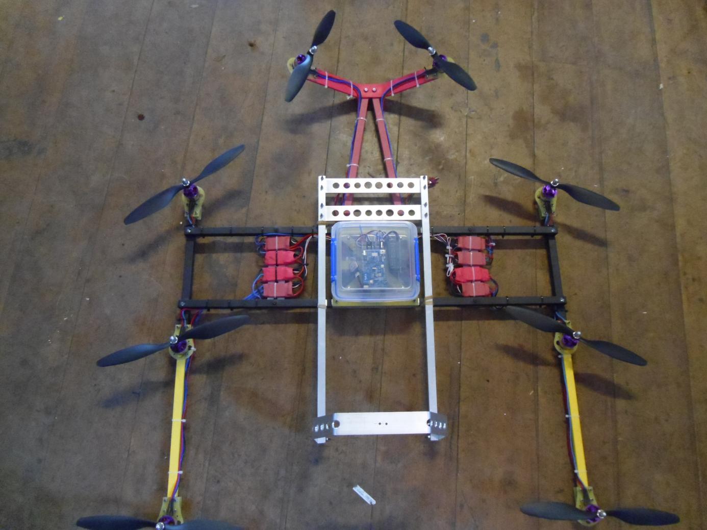

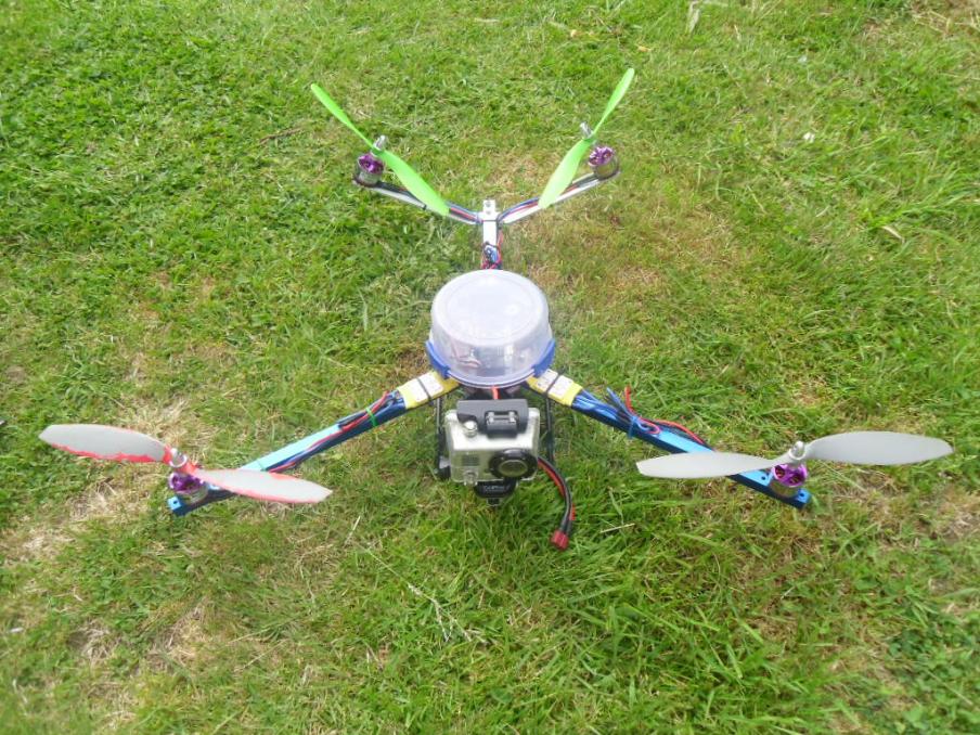

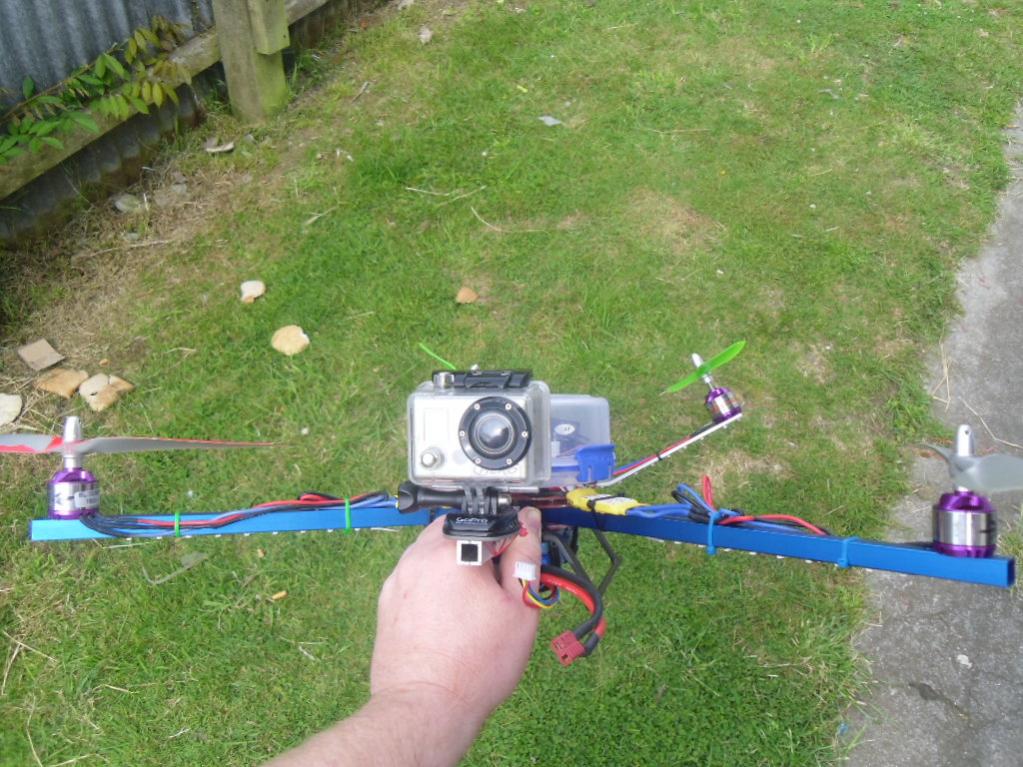

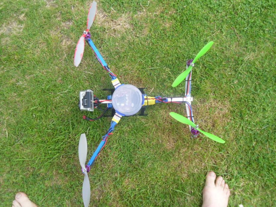

the best way I have found to keep the camera clear of the props, and keep it at the centre line ( cut down on pendulum effect) is to cantileaver it, push the camera forwards and move the battery back to compensate.
Seen lots of guys fighting vibration and using all sorts of things to stop it, I am not much of a videographer but have always found hard mounting works well, as long as evering else is balanced, but then my standards are low :)
Keen to follow this thread, as want to do some action filming.
