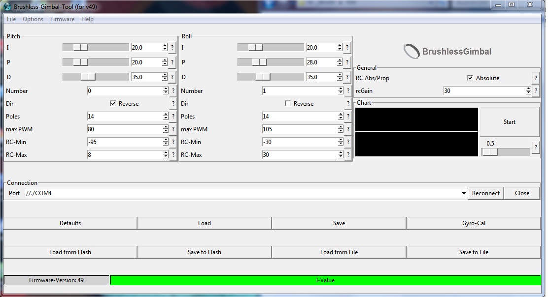

I'm having an issue getting the gimbal to connect up with the ActiveTCL program for adjustments.
I'm using a machine with Windows XP, got the COM port drivers installed and the USB com port shows up in the device manager as COM5.
I can see COM5 in the ActiveTCL program, but when I connect the connection box stays yellow and all of the parameters stay greyed out.
Any suggestions? I'm at my wits end... Updated the gimbal firmware tonight in hopes of getting the 90 degree down tilt, and it seems that all of the settings have been screwed up now. I used to get smooth up-down tilt, but now it gets to about 20º down and "bounces" back, tilting up toward level as I continue to turn the adjustment knob. Really frustrating!
Thanks guys.
Okay... just spent the last 2 hours screwing with that and FINALLY got things right. I downloaded the new version, 049b_r77, and it includes a .exe GUI for the gimbal settings. Connected perfectly, adjusted settings (note the PID I has been divided by 10 in this version!!) and saved to flash... gimbal is working normally again but haven't input Bengit's settings yet. That's next... then hopefully I'll have 90º tilt.
Good luck, please be aware I am using -r61, the setting MIGHT be different....
