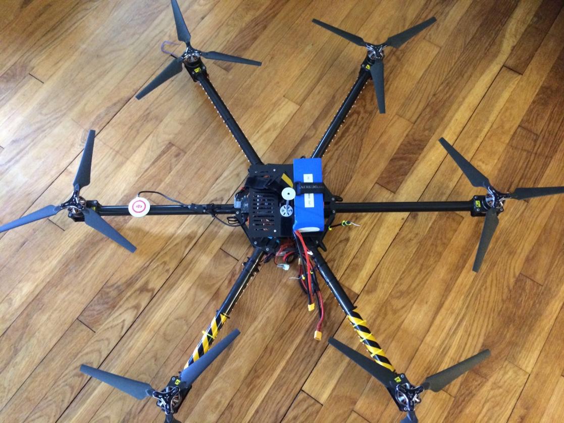

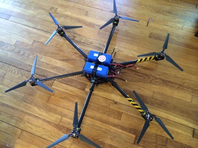

O I had my WKM on an Octo.. no issues. Would calibrate the compass in 1 try every time.
Slapped it on a HEX and it will not get past the Green and Yellow flashing "compass problem" lights.
One time in the house it went into normal modes, and allowed me to calibrate the compass INDOORS.
SO I got excited and went outside.. GREEN and YELLOW... compass calibration failure every time.

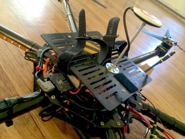

The puck is around 5" above the top plate of a RC Rotors Hex frame. Batteries to the right and left.
I had ferrite rings on the ESC's and I removed those and that is when the WKM let me calibrate it inside.
Have not put them back on, so I thought that was the issue. What the heck else could be causing this?
I got so mad I just tried to fire up the motors with the green and yellow flashing, it took off and flew pretty good in manual,
so I know everything is working.. just this damn GPS/Compass.
Again, this is/was a working WKM, just removed from an octo and transferred to a hex , no crash no weirdness...
ANY THOUGHTS!?!

Not seeing it on the WKM GUI. I also just stuck the puck on a 12" post.. still nada. Starting to think the puck went bad.
