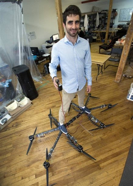

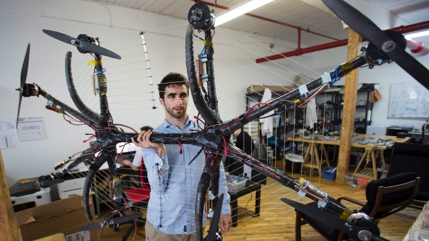

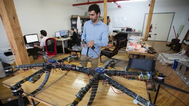

I have found three pictures and two videos (see attached) showing C. A. Duru's 8-rotor helicopter in the lab and flying.
However, I have not identified too many technical details regarding this hovering machine.
Maybe you can infer from the images what:
- motors
- batteries
- propellers
etc.
C. A. Duru uses?
I am interested in finding out how much such a hover-board might cost and where I can find the necessary components.

I was sugestted to use eight U11 T-Motor (see: http://www.rctigermotor.com/html/2013/Power-Type_0928/93.html).
Tested at 50 V with a 26*8.5CF T-MOTOR propeller, an U11 lifts 12.42 kg. So, eight U11 units will be enough to hover 99.36 kg drawing 379.2 A (379.2 A x 50 V = 18.96 kW) in total.
A group of eight U11, which costs n0 less than $350 x 8 = $2800, looks a good candidate for C. A. Duru's flying platform. However, a 50 V, 379.2 A battery is needed.
Source: http://www.rctigermotor.com/html/2013/Power-Type_0928/93.html
