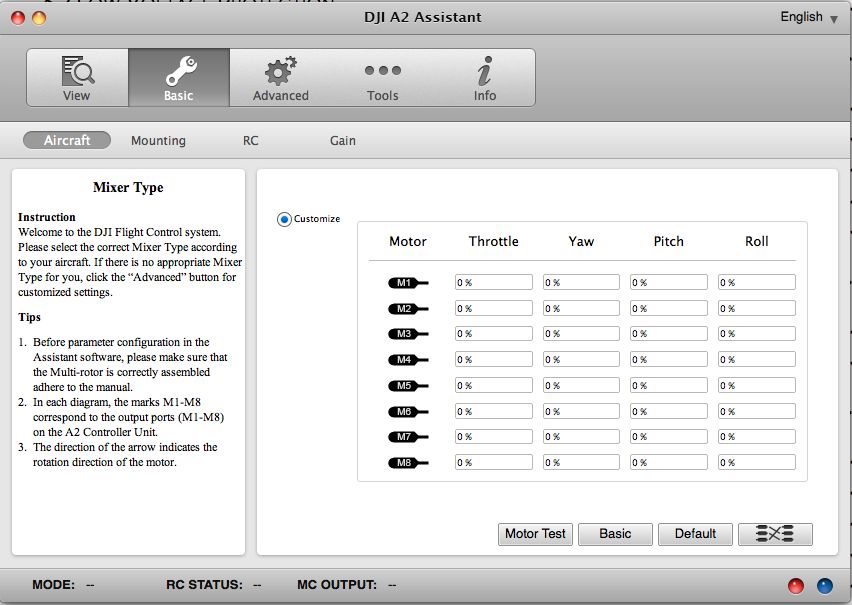

The A2 gives the user trough the Assistant software the option to adjust parameters in the advance motor mixer window assuming that the default is the general way to use it the default is set 0% I wonder what 0% means?
Mikrocopter FC mixer window had values of 64 and -64 across all of the mixer boxes as defaults, in recent months MK did a slight modification to the default values where for example in a octo mixer, motor #1 and motor #5 had no value on roll, and motor #3 and motor #7 had no value on Nick, when you look at it it makes sense
so the question is: base in the theory that a mixer in DJI or MK may work similar has any one experimented with DJI A2 or Wkm mixer values on a simetrical octo, hex or quad? what the values would look like if we copy the MK way, and would this help the overall flight performance stability
