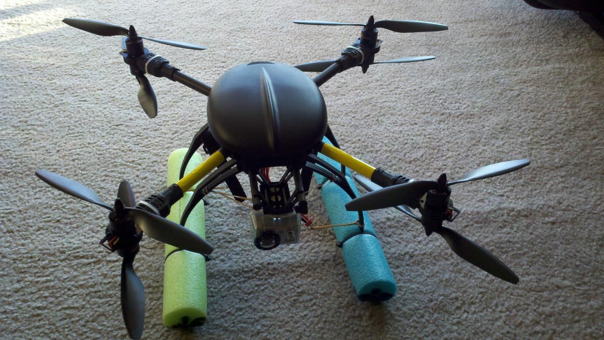

For those who may be following this thread and not seen my post on my build log, the MK X8 flew beautifully yesterday after getting it ready for flight. I used default settings and it flew the best it has ever flown. Absolutely incredible! Three flights fully weighted with two batteries and dummy camera weight.
I made a comment in the build thread post about if you want the best performance you need to spend the money on the best available. I just want to add that I am still disappointed that I have had to spend so much time testing the distro board to make sure it wasn't going to go up in smoke and I am beyond frustrated that a diode would pop off a BL. Very disturbing. All we can hope is the H&I will start demanding better QC as new players join the market. For what I need the copter to do there is no match to MK in the same price range.
Thanks so much for everyone's help!! I couldn't of gotten this thing flying without you all.
