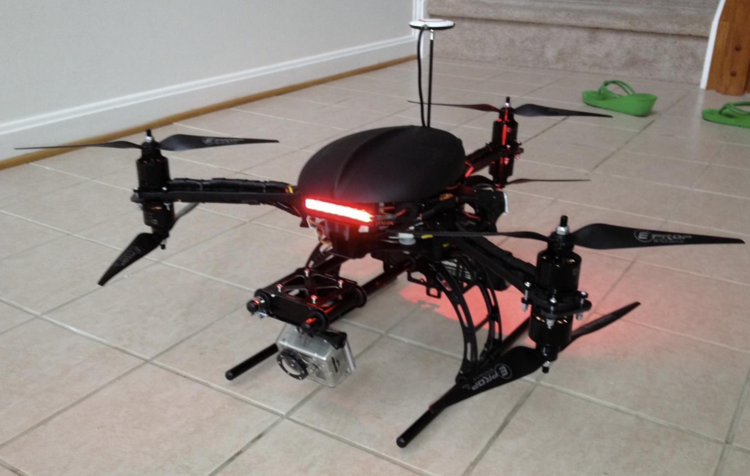

The 10.38 SF and SFP (Slow Fly and Slow Fly Pusher = right rotation and left rotation). For most multi rotors you need opposing pairs of props to counter the torque. APC props are good. They can take a beating and still fly. They also flex vs. self destructing in flight. For me that offered a smoother transition of movement which IMHO resulted in smoother video/photos. The Graupners are the cream of the crop. Big hub, firm blades, quieter, and I achieved long flight time. Movement is crisper than APC. I had to adjust gains to smooth out the flights. I like the look of the GraupnersView attachment 6088.
