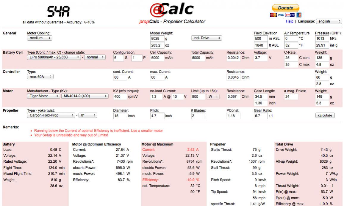

It is flat. I could probably fit 16" props on there. I have been fiddling around with eCal but it doesn't like my data. What am I doing wrong there? Here is a screenshot...

Sorry, I don't know why it shrunk down like that. Here it is as a JPEG. Perhaps this will work better.
This is what it said...
  • Running below the Current of optimal Efficiency is inefficient. Use a smaller motor
  • Your Setup is unrealistic and way out of Limits!
My problem with ecalc is, being a newbie, I don't know all of what it is asking me. I couldn't find my exact battery specs for example. And in "model weight" is that my gross weight with camera, gimbal and everything else?

cbuk
You're in propCalc and not xcopterCalc..... That's why your calculations make no sense. Use xcopterCalc and you'll be able to input the number of motors. You should get realistic results then.

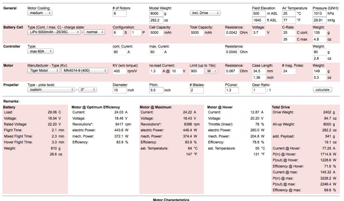

teecee
Wow, that (obviously) makes a huge difference. It now says I am at 78% throttle at hover. Should I be comfortable with that number?

cbuk
I'm a little out of my comfort zone here giving advice because I dont want to be giving you the wrong advice. If it were me, 78% is a little too close to the 80% limit for comfort. You would have very little thrust in reserve should you get into any problems. Descending might also be a bit hair raising.
Another lipo would increase your flight time but also your AUW so I suspect you would still be facing the same hover throttle problem. Hopefully someone else will chip in.

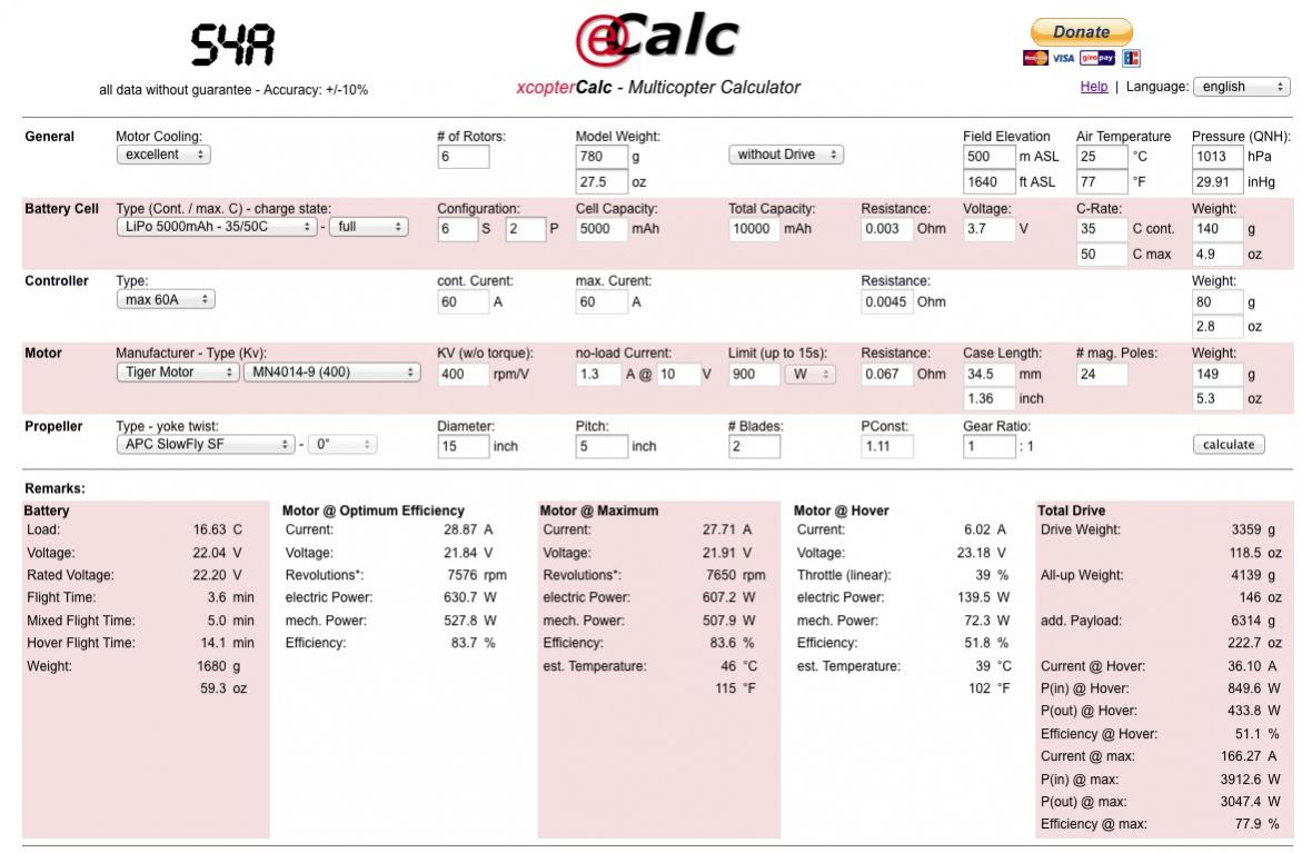

If all your components are listed in the drop-menus - select " without drive" and it will calculate in the weight of each individual component on its own. The only weight you put in the field is the frame/FC weight.
If the battery is new - you can probably choose "full" next to battery type.
After you plug in all the info - the bottom will tell you the payload capacity - which would be where you see if it will lift your camera/gimbal rig.
You our definitely want to be at around 50% throttle @ hover. Below is what I got when I entered the data into eCalc. Not sure if I got everything correct - but notice that the battery is entered as "6S" and "2P." The 2 P is an additional battery of thesame type. They don't list 5400, so you can put in 5000 (you may get better results than shown here with your extra 400mah). Also, enter in the 35C as the lower number in the options - that's what your battery is capable of.
This is how I was taught to use ecalc anyway...

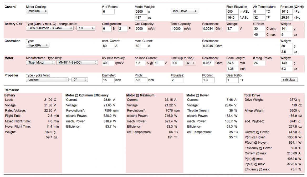

OK, now I am confused again. What exactly is considered "drive" in ecalc? I don't have my frame/FC weight as the whole rig is assembled. I do know total weight. If I say "incl. drive" does that assume that I have accounted for all components myself? It doesn't seem to as it is putting 1864g in the "add payload" on the bottom right.
OK, I just ran it again with my actual weight (no camera and gimbal)of 5300g and set "incl. drive". It lists 4564g as "add payload" on the bottom right with 60.8% efficiency at hover listed. Does this mean I can add 4564g and be at 60.8% efficiency?

Motopreserve
Sorry, didn't mean to make it more confusing. Yes, the "including drive" means you plug in your all up weight. If you use the other option (without drive) you plug in the weight of the frame (I looked up your frame - shows 780 grams). Your results show a hell of a lot of payload capacity. Roughly how heavy will the gimbal and camera be?
The big issue with your eCalc results is that A) it is over the 50% throttle mark for hover, and B) it gives you under 5 minutes flight time. Spirited flight is closer to 2 minutes! That doesn't leave much room for fun and whatnot. :)
Also, change your battery to show 5000mah, 35C/50C. Start messing with the prop sizes. And add a battery if your payload will not be completely be used by the Camera rig. See if these hep the flight times on the lower left of the ecalc window. Put the prop type in there too (Slow Fly, etc - although this doesn't change the flight times much)
