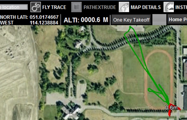

Actually the POI, i.e., Point of View feature is, according to my manual, a built-in feature of WKM and can be activated from the IOC function by your RC transmitter when properly configured. One does not need GCS to achieve that although it may be possible to activate POI from GCS as well. In it's most basic form when you fly with your RC transmitter, you can also connect your GCS. In this case you will have the realtime 3d GPS position of your MR for tracking purposes in a worse case scenario.
I tested this out today without taking control of the MR from GCS and here is what I was able to capture as a screen shot..... quite simple for the experienced GCS user but useful perhaps to others.
