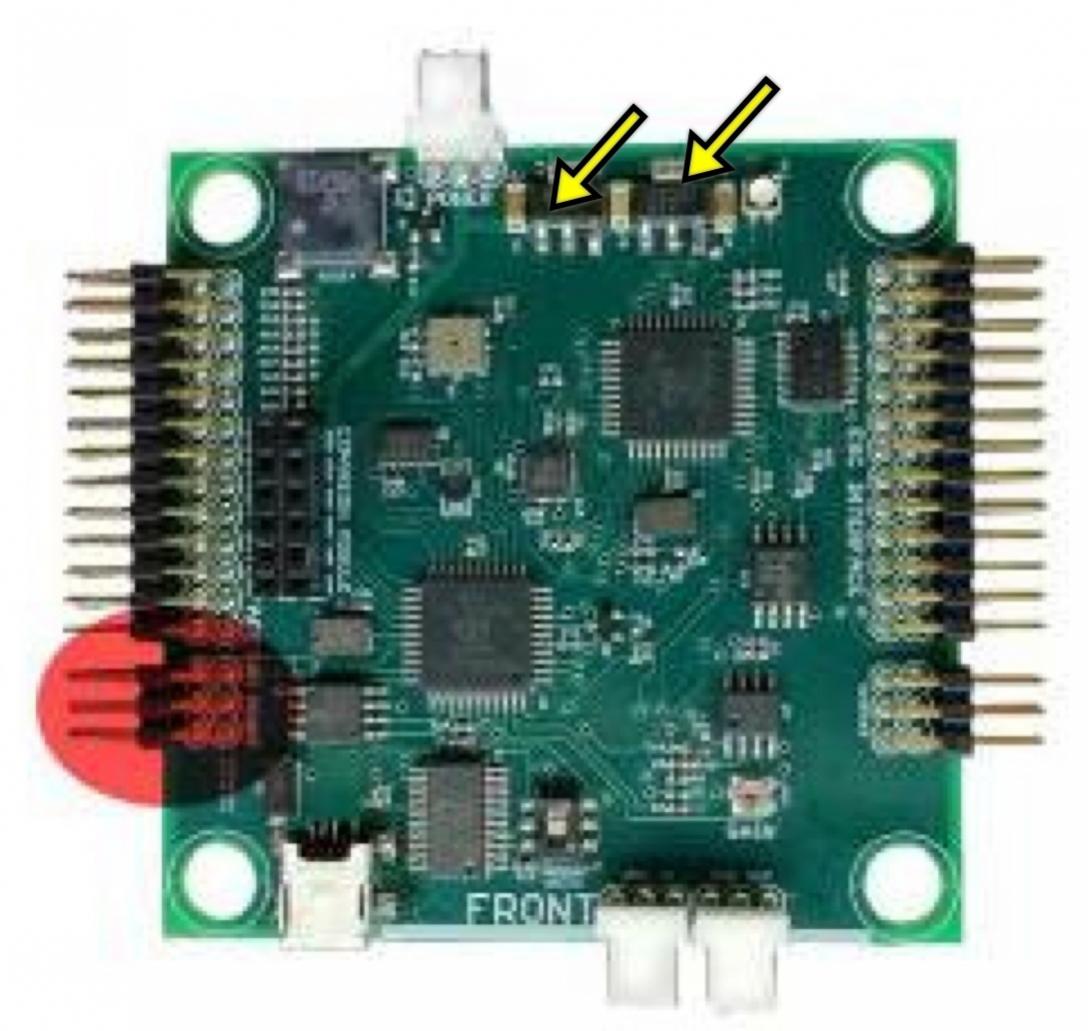

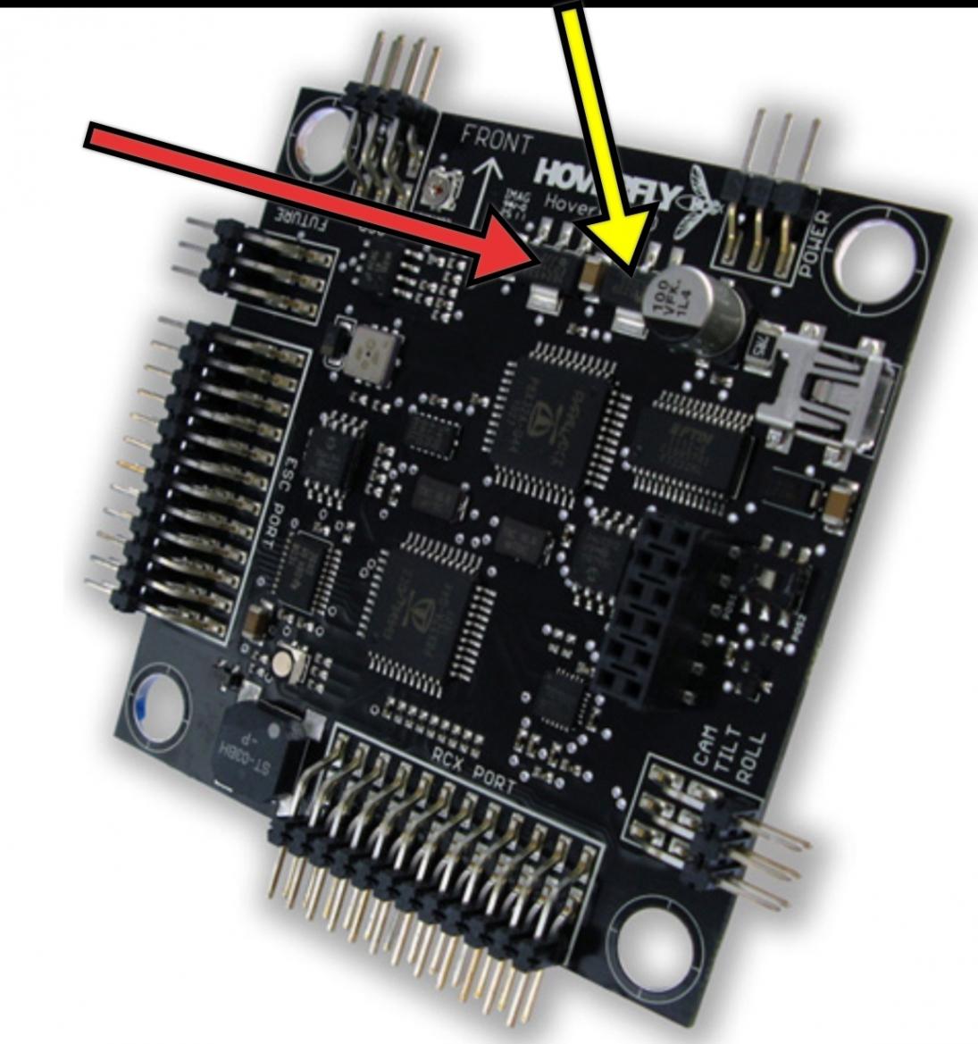

I'm at work and I don't have the HFP in front of me but the picture attached is the HFP with the two arrows pointing to the voltage regulators. I AM IN NO WAY SUGGESTING THE FOLLOWING. DO ANYTHING AT YOUR OWN RISK
A heat sink could be placed on each of these or one over both. Careful not to short anything over the board. Write down the numbers on them and search the Internet for the specs. Just a quick search on SMD voltage regulators I found some with a absolute max input voltage of 20v and some with 16. Depending on the current draw, the power dissipation (heat) could be more or less.
I have not done this nor do I suggest doing anything against the manufacturer's recommendations.
Be careful.

Same cautionary advisories.....disregard the little red circle in the lower left. It's from the manual and doesn't apply to this discussion..
