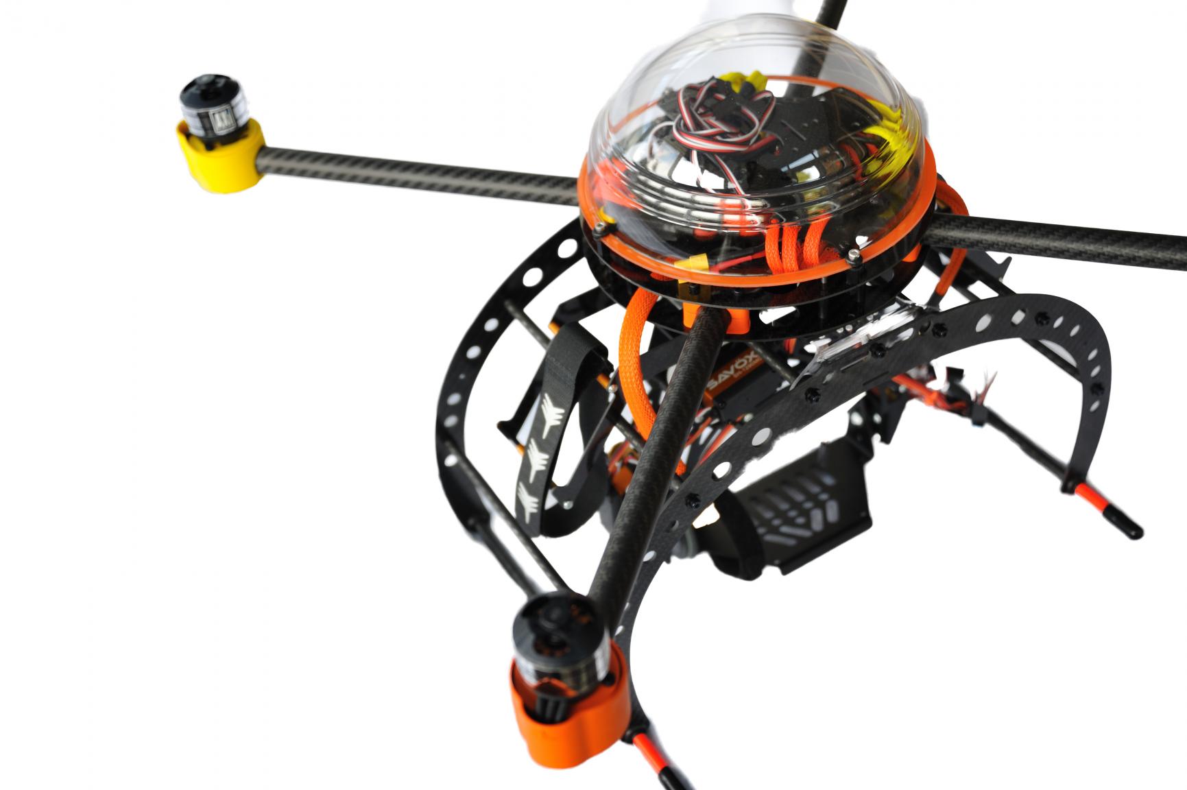

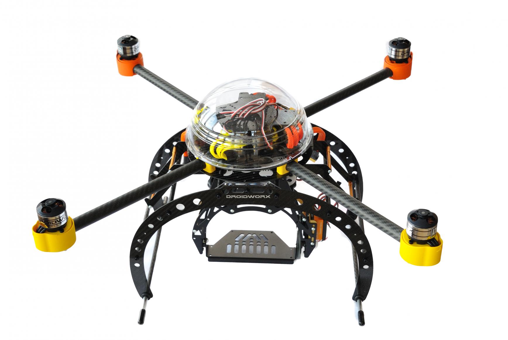

Hi Vin
The last F550 I did was for a client and It had a NAZA-M with GPS so a bit different from yours but the gains ended up being 180 180 140 150 / 130 /130 and it was perfect. The commission build I am doing at the moment is a lovely old Droidworx AD4HL with WKM and that is totally different at 110 110 120 140 / 120 / 120 so no comparison.
Here it is before completion.
View attachment 7711View attachment 7712View attachment 7713
Regards
Andrew
