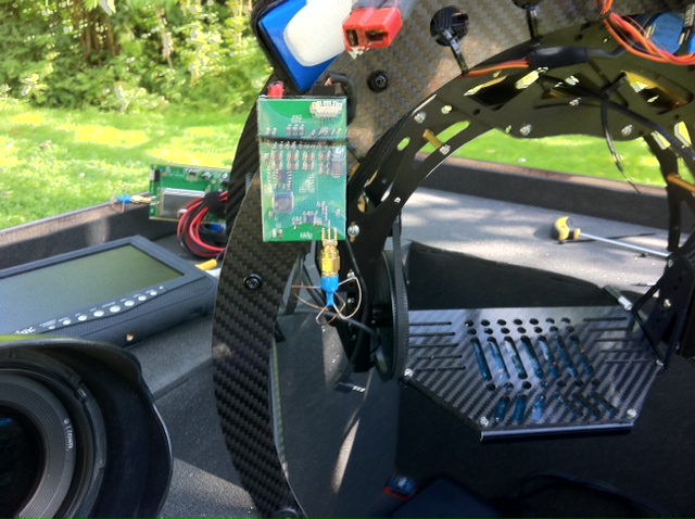

i did some aerial fotos today for a friend and hocked up the video downlink gear. I took the kopter straight up for 30 35 meter and higher and my video signal dropped dead. I am a little disappointed hopping it can do at least 50 m plus.
I have the transmitter attached to my carbon landinggear, to one side of the DW Ext landing gear. Could that be the reason for this bad signal strength ?
Boris
Setup:
ImmersionRC 600mw
Cloverleaf Antenna, Bluebeam
Nano 5.8 Receiver,
also Cloverleaf Antenna, Bluebeam.

Boris, the antenna your using has a blind spot right under it, try an inverted V if possible or swing the antenna through 90 degrees & see what happens.

ah okay than i misunderstood the bluebeam guy, i thought he said head down or head up it should be mounted. I will try that thanks !
Macsgrafs
There was a thread over at RCG & the designer was saying that overhead can cause range problems, just swivel the whole thing 90 degrees & see what happens. Let me know will you my friend so that I can see what the range is like

Way too much carbon fibre. I avoid carbon and metal (as much as possible) for my FPV builds. Carbon can block and interfere with radio signals. You should get some serious range with 600mW. I run 300mW Vtx (1.3ghz) and can easily fly 1km.

U cant compare 1,3gHz and 5,8 gHz. Lower frequency - large range. With 600mW i have good range between 400-600m. I use coverleaf and 13db patch.
With 900mHz and 1W my range is almost 2km with no problem.
@ Boris
Try on receiver normal antenna not coverleaf.
I had similar problem with Airwave 7ch 5.8GHz Receiver, when i used coverleaf my range was 10m or less or even black screen.
I puted on receiver normal 3db antenna, range was 300m.

So I guess my approach would have be to get the atenna as far away from the carbon as possible. So would the antenna directly on the landgear or 30 cm away from the nearest carbon piece make a significant difference ?
