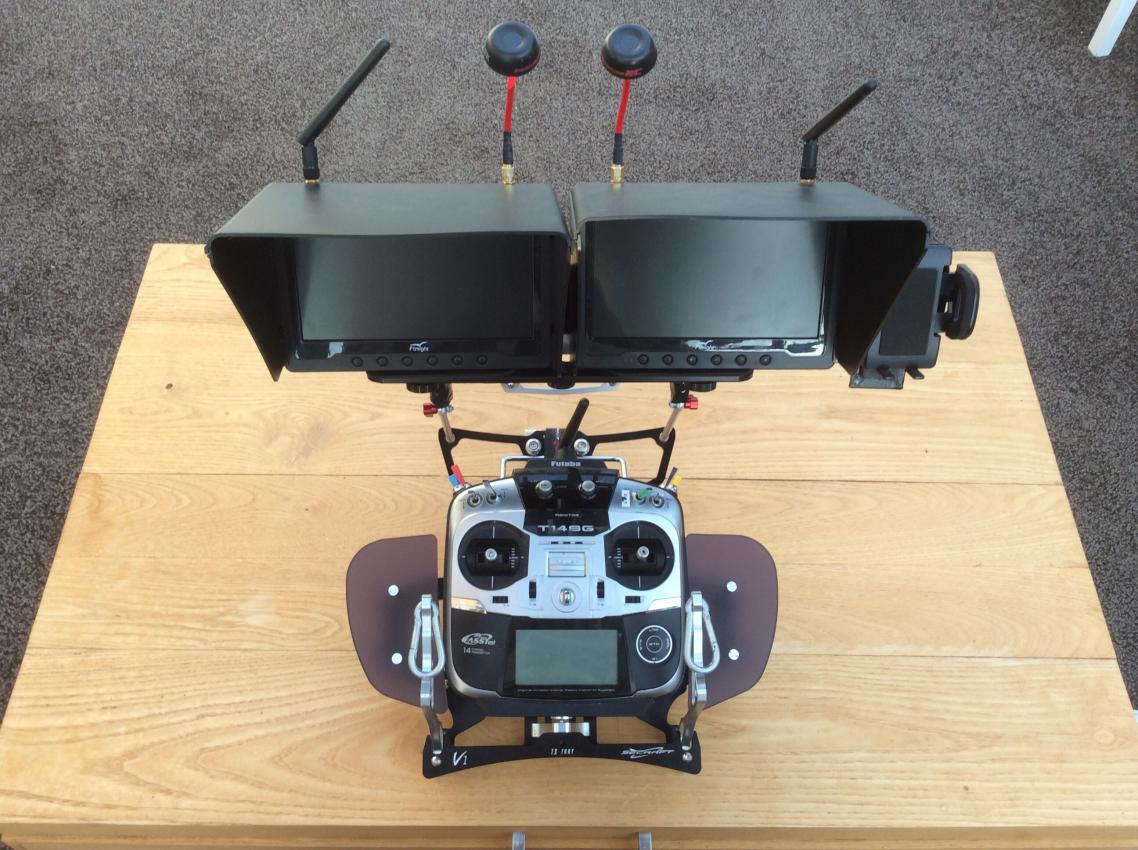

I fly both one and two man. I've put two monitors on my TX, one is the FPV camera which has all the iOSD info and the other is the GH3. When in two man mode I can get some idea of what the cameraman is trying to achieve this way. In one man mode I used to use a monitor on a tripod but doing how I do now means I can turn an keep an eye on the aircraft at all times.
