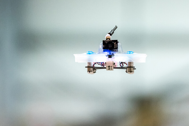

Tiny Whoop is a small FPV(first-person-view) micro brushed quadcopter, its propellers are protected by EDF ducts that also makes it a very efficient little machine, we can fly FPV around people and kids safely. It allows some insane indoor FPV flying: chasing people, annoying your pets

What do we need know when we build a Tiny whoop?
A typical build will contain the following parts:
  • A frame (80-100mm should be good)
  • A flight controller (the SPRacing F3 Brushed is a great choice)
  • Motors (8.5mm brushed) & propellers
  • Battery (400-750mAh; 1S/2S)
  • Receiver (depends on what transmitter you have)
  • AIO (all-in-one) camera (the FX798T is a proven champ)
You can read our Quadcopter frame, lipo battery, motor and propeller size matching table to know more about how to build quadcopter.
