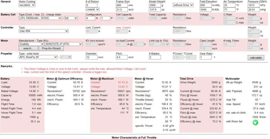

Couple of solderings and my new x8 setup is ready for first flight.
All stuff included (is this UAW in english) it is about 6,5 kg, motors are Dualsky XM5010TE-4, esc´s Hobbywing XRotor 40A and 1 x 10000mah lipo, carrying GH4.
How does this combination looks......can it even fly and i think i´ll go with 1.0 or 1.1 gains in SuperX?
edit : props are APC 12x4,5

Well the MAX weight those motors can handle with a 4S battery is 6.6 KG so you are at the limit of what those motors can do. Most likely you will have less than optimum performance.

Thanks for the replies..........damn, i´m not very experienced with building these and i trusted someone which i thought would know better :(
Will it make any difference if i try bigger props, or is it even worse that way?
edit : or can those esc´s and motors handle 6s....
zak69
yep.....only few minutes of flight time, so i think i move on to 6s.
Esc´s are ok with that, but can someone recommend motor/prop combination......kde, t-motor etc.....i´m looking for at least 10 minutes rather 15 minutes flight time with full load?
