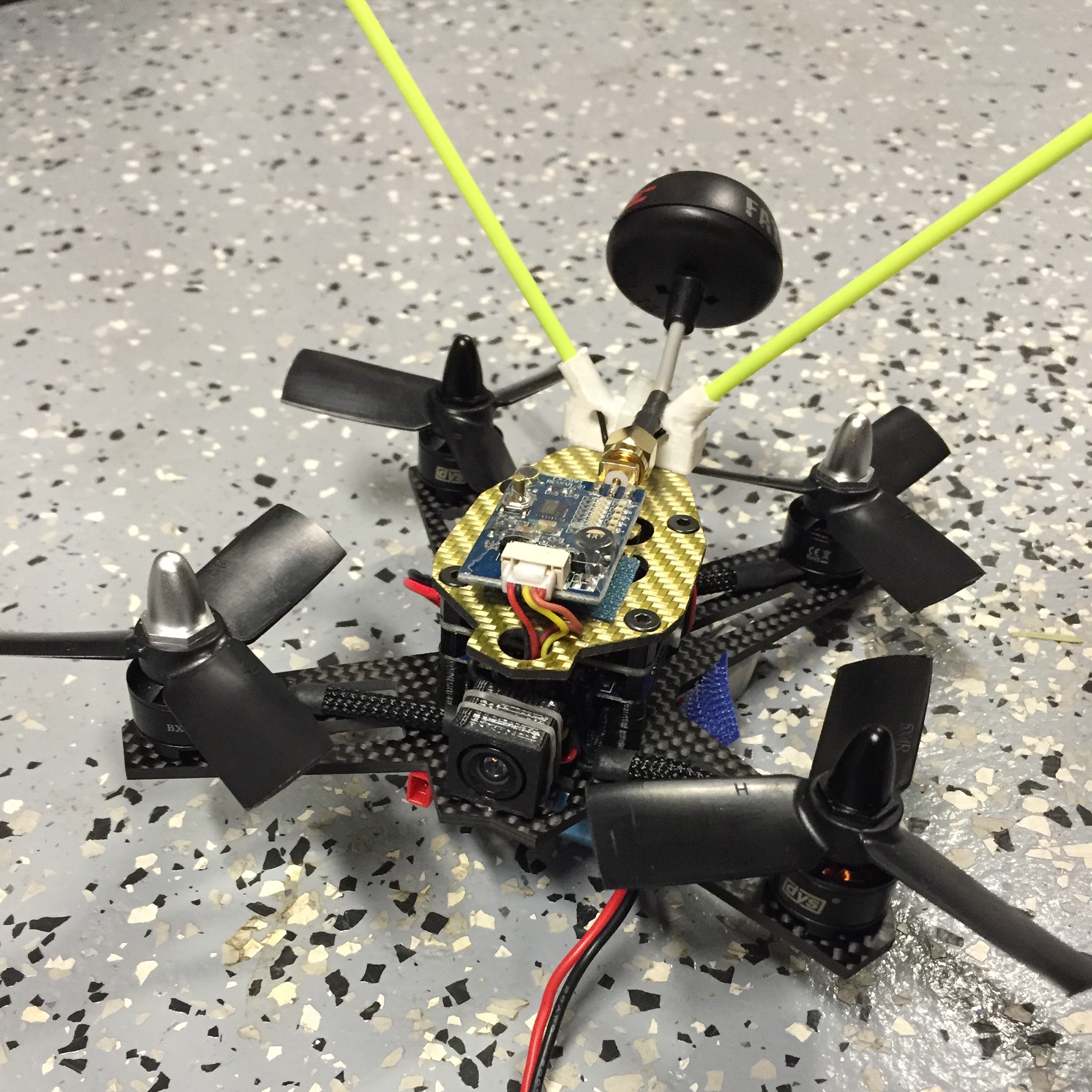

Talon Six
I've got two racers, a stock Vortex and a QAV180. The Vortex is nothing special, just insanely overpowered on 4S batteries.
Here's the QAV:
This is a 3S setup with T-motor 1806s spinning 4" HQProp Bullnoses, a Naze/OSDoge stack, and DIY 20 amp ESCs (overkill, I know). I use the Taranis radio for all my non-DJI drones, so there's a DR4 receiver and a 25mw race band VTX on the back end of this racer.
I'm using the Headplay HDs for my goggles (if you can call them goggles).
To the left of the QAV is a Dogfish Head 90 Minute IPA or "builder's fuel" as I like to call it. The beer is for size purposes only - drinking and FPVing don't mix since you might spill your beer.

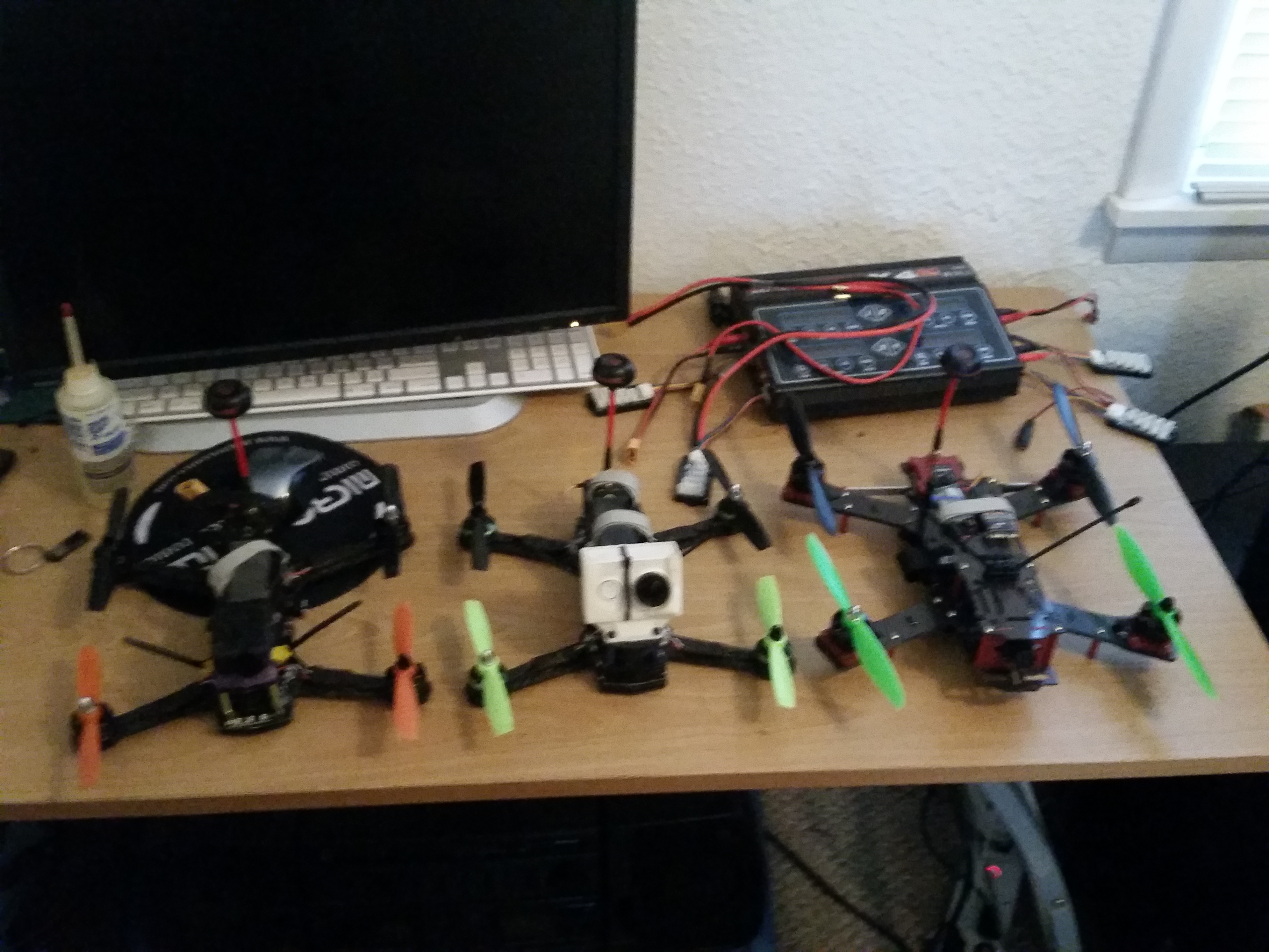

I have a few.
ZMR250 (1)
DYS20a
Naze32
Emax 2204
5045 Bullnose Dal Props
Surveilzone Board Camera
TS5823
Mobius on 15 degree ramp
ZMR250 (2)
DYS20a
Multistar Elite 2204
Naze32
Fatshark 250mw
Fatshark 600 tvl
5045 Dragonfly Props
Xiaomi Yi in Custom 20 Degree Mount
FPVModel ZMR180 Pro
Little Bee 20A
T-motor Navigator 2204
Naze 32
700 TVL Board Camera
Eachine 200mw
Dal 4045 Props
And a Nighthawk 280 Pro Stock Setup
I fly them all from my modified 9X transmitter with a Frsky module and all have D4R-II receivers and Spironet Antennas. I fly with Fatshark Attitudes, and keep a pair of Fatshark Predators for passengers.
This is my first post by the way, love the podcast and glad to be a member of the new forum.

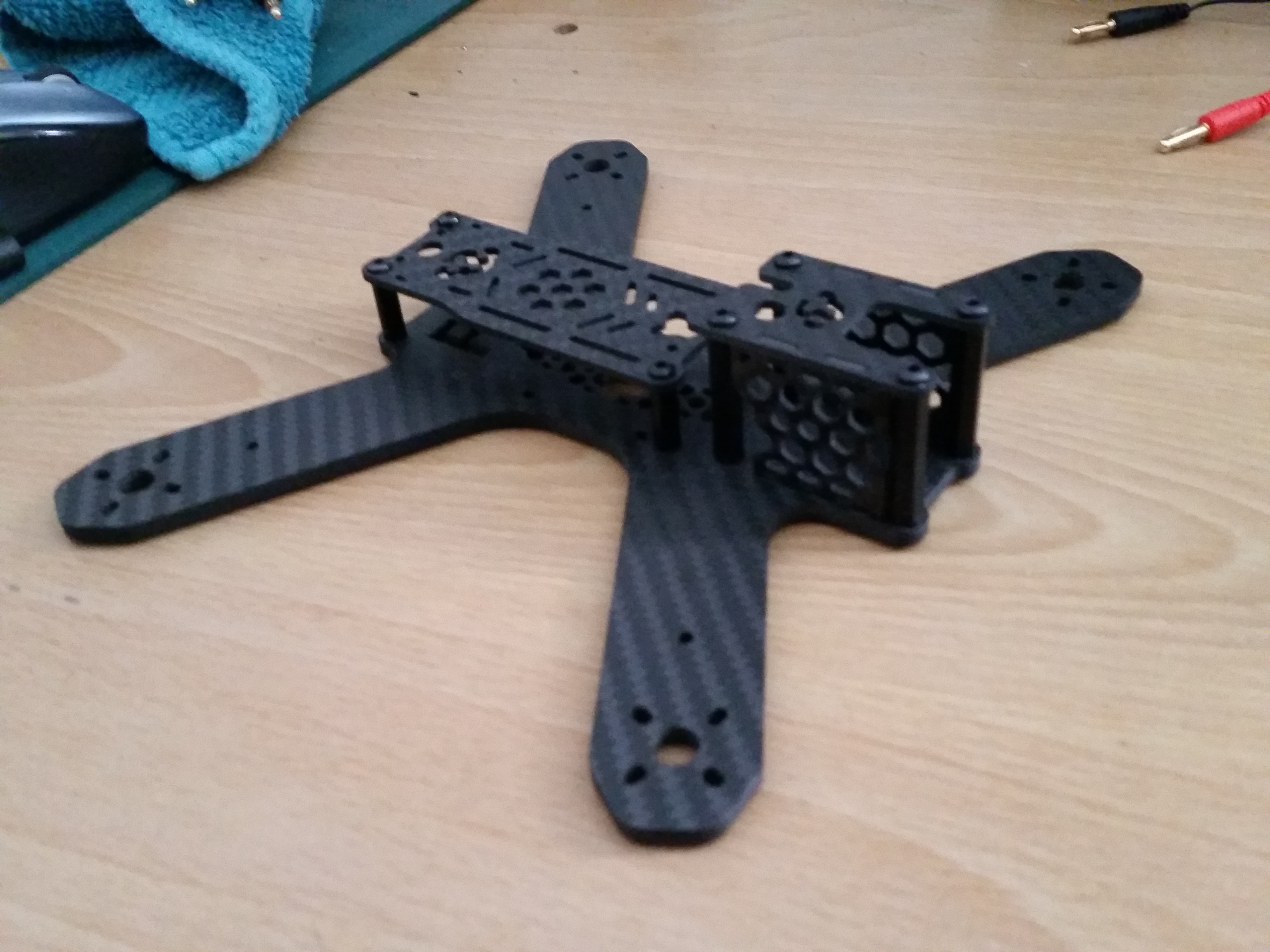

Just picked up a new frame at WRAM yesterday, its a FloRotor Hive 210 Safety Third Special Edition. Stay tuned for build pics to come.
