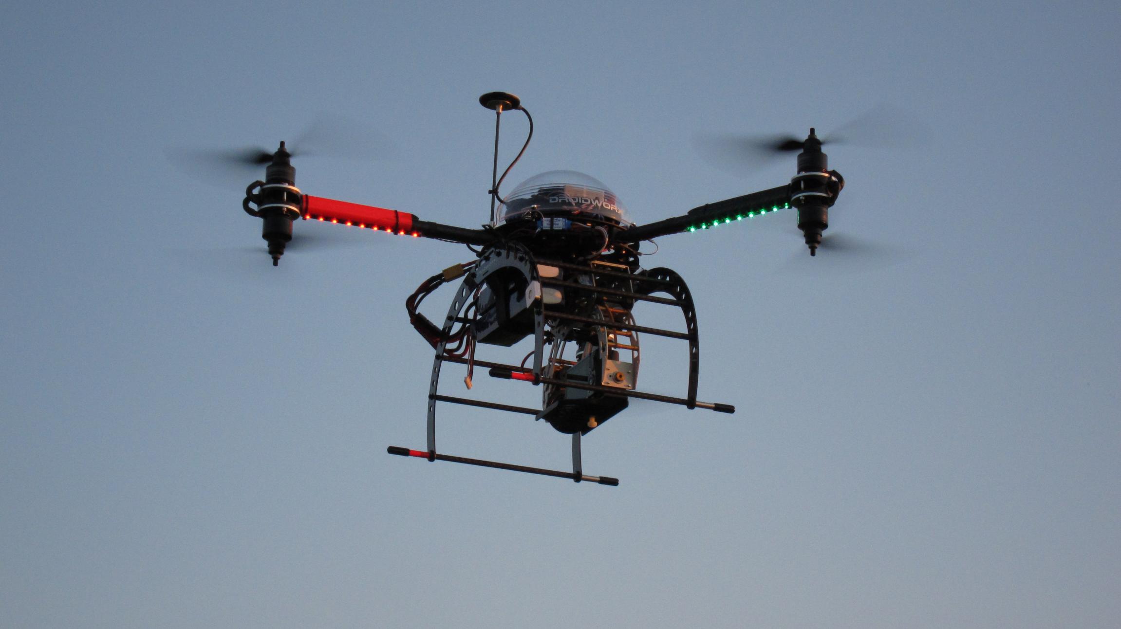

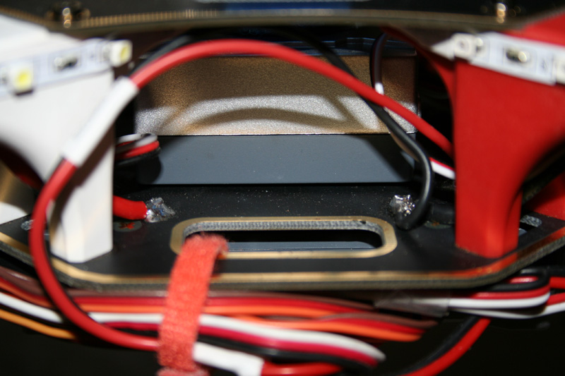

We Just Completed a really Nice Machine for a Client and I thought I'd Post Some Pics of our Build.
This is a Custom Built DroidWorx Y-6 V3 HL with Wookong-M Flight Controller.
Specs of Build:
Frame: DW Y-6 V3 Heavy Lifter
Motors: Avroto 770KV
ECS's: HobbyWing 30amp
Props: Graupner 11 x 5 E-Props
Flight Control: DJI Wookong-M
Camera Gimbal: PhotoHigher AV130
LED's: Xogear WaterProof
Custom Made FC Plate For Wookong-M
Custom Made ESC Power Distribution Harness
Remarks:
This set-up proved to be extremely stable and Nice to fly Machine for AP Work.
Our customer gave us great feeback and we will be build more Machines for His Business.
For Details Visit our Website at RcHobbyHelicopter
Cheers, John W.
AddictiveRC/RcHobbyHelicopter
N. American Distributor for DJI-Innovations Products.
View attachment 2749View attachment 2750

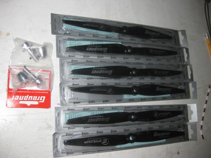

To say we are delighted is an understatement. The quality of the workmanship is completely pro-level and I would recommend AddictiveRC to anyone needing a build for professional AP work. John told me the Graupner props would make a difference and I have to say this thing flies like butter and is much quieter than the AD6 (which has bigger APC slow-fly props on it). John also told me that our WKM mounting on the AD6 was too close to the electronics and, again, it is clear that he knows what he is talking about. He cut a slot in the crash dome so that he could mount that GPS/Compass on a high mast on the front boom. The thing gets full GPS lock with no red flashes in less than 30 seconds and when we switch to GPS mode it hangs in the sky without the "toilet-bowling" we've been struggling with on the AD6. I've ordered more Graupner props to try out on the AD6 and I'm going to remount the GPS/Compass to match what John did here to see if we can match the performance of this new bird.
