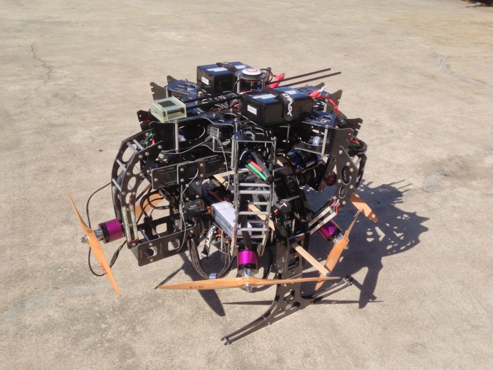

So ever since I got my zenmuse, i noticed there was a little bind point in my roll axis. With the aircraft un-powered and hand spinning the gimbal roll, you could definitely feel and hear that something was rubbing. You could spin it and it would stop at nearly the same location every time. If it were the $1.00 wheel on The Price is Right, I'd be a rich man. :)
Totally not something the Zen should do. When the aircraft was powered, my Zen would "creak" Dealer was perplexed.
My dealer told me I had 2 options. I could send it back to China and be without it for 3-4 weeks, or they'd offer me a trade in on a new one (not free) booooooo. "A Trade in" on a unit that is only 2 months old and has been this way since I pulled it out of the box. I thought that was kinda crappy.
So I came home and started troubleshooting.
Even though it's not noticeable I think there's a slight flaw in the roundness of the roll axis housing because it would rub in a consistent spot. Funny thing was, it was simply rubbing on a collar that attaches the lower cross bar and roll servo to the vertical tube for the pan axis. As the screw got snug and drew the collar tight (RED CIRCLE), it created a pressure that brought the tab inside the roll housing outward creating the rub.
The solution? a little loctite and i loosened the screw about 3/4 turn. Instantly the rub was gone but the best part and unexpected consequence... MY RAW FOOTAGE IS ROCK SOLID STABLE.
I'm soooo freaking psyched!!!!
