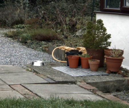

I have a new GH3 gimbal which I've balanced a Blackmagic Pocket Cinema Camera on. The camera balances perfectly but the gimbal motors are very noisy (my older GH2 gimbal was silent).
Along with the noise I'm getting serious high frequency vibration which is destroying the image quality.
I've attached a couple of still frame grabs from the video (a crop of the full frame). The first frame grab is very soft and is from video shot with the copter on a bench with no rotors running, just the gimbal powered up. The second frame is from the same video clip after the power was removed from the gimbal.
Anyone else seeing this problem?

View attachment 15553View attachment 15554
