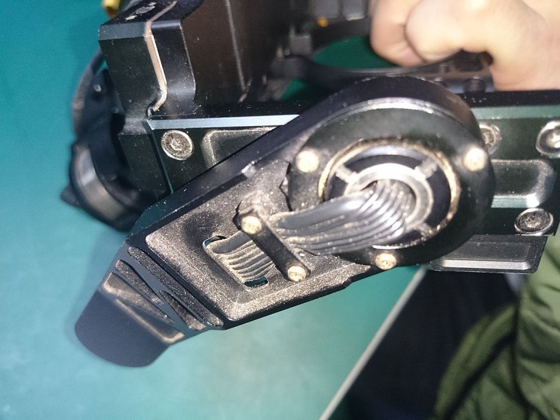

To me that looks like an issue of an unbalanced prop or motor. Also, you are getting a strobe effect from the props and the light, you may want to add some kind of light shield above the cam... or even a lens hood (you can make one out of a pill bottle, and it’s so light the gimbal doesn’t know it’s there...

Thank you so much sleepy c. I will try changing the props and see if that makes a difference. I am aware of the stroking caused by the propellers, I appreciate the solution you sent. Any other ideas what might be causing the bouncing?
