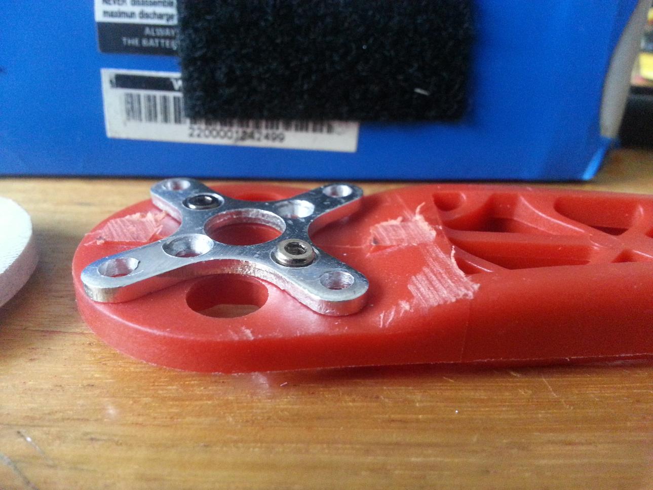

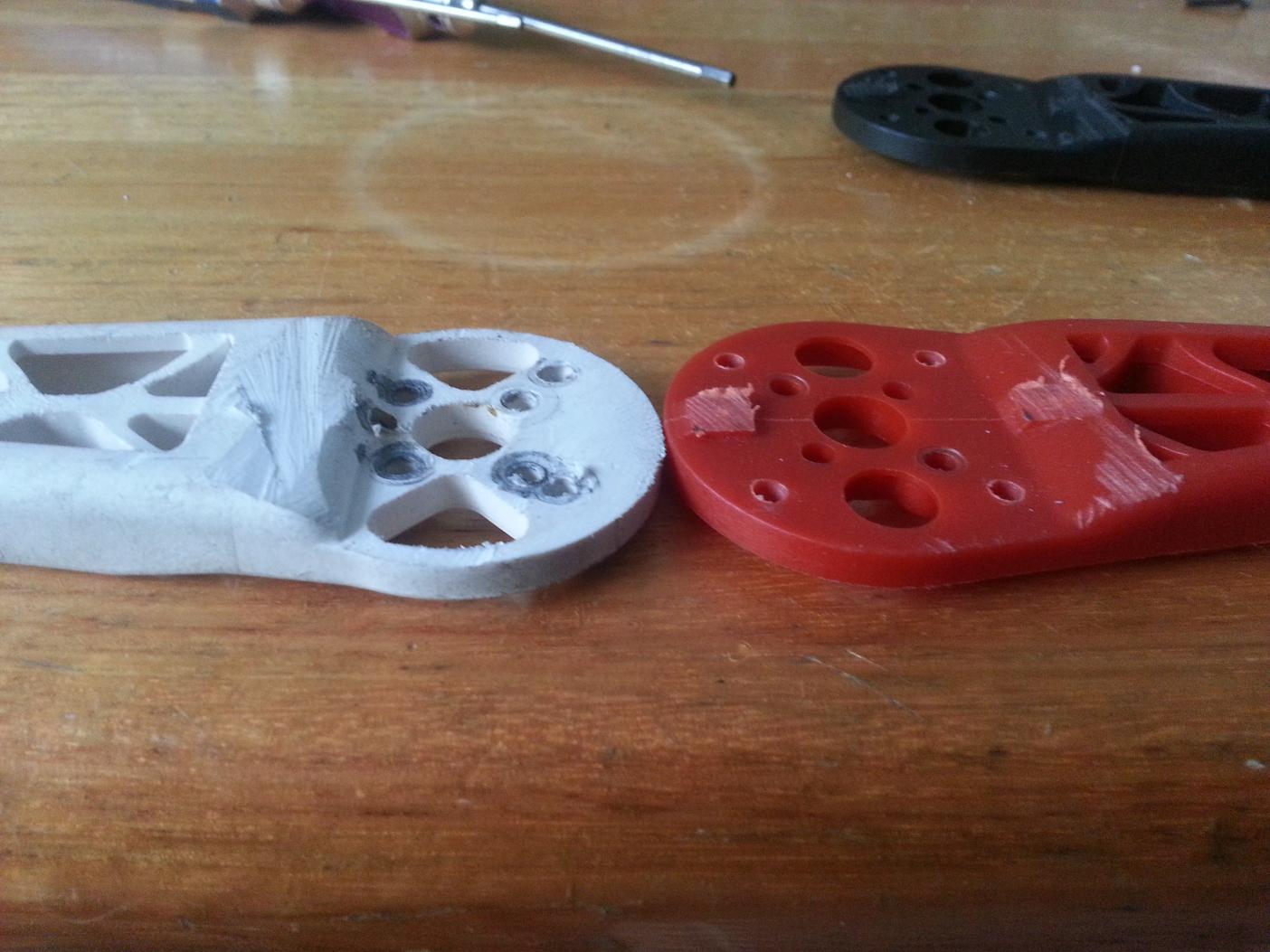

I've just finished modifying both my F550's to Y6 The thing that convinced me was the redundancy of motors, My frat one was on NAZA and i had a faulty ESC as i was in the hover i saw the bottom right motor stop yet the aircraft was still totally controllable the only difference I saw was a tilting in Yaw. With the standard DJI arms its quite a fiddle to get both motors fitted but I got some aftermarket arms that have a much larger flat area I got mine from RC Timer R550V2(Black/Red) Glass Fiber Hexcopter Frame 550mm - Integrated PCB VersionView attachment 17830View attachment 17831
