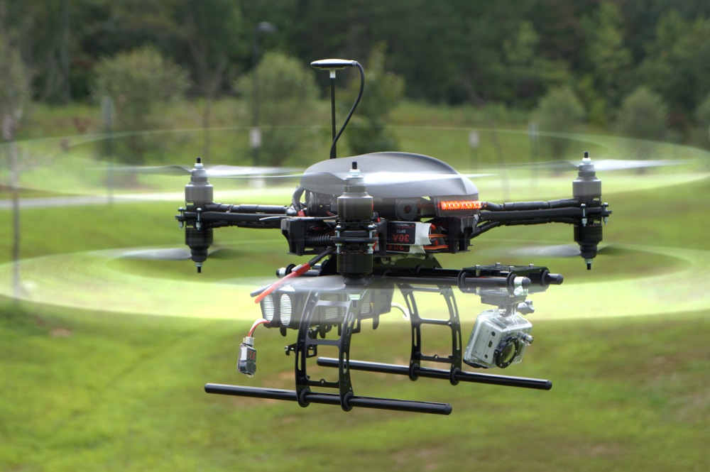

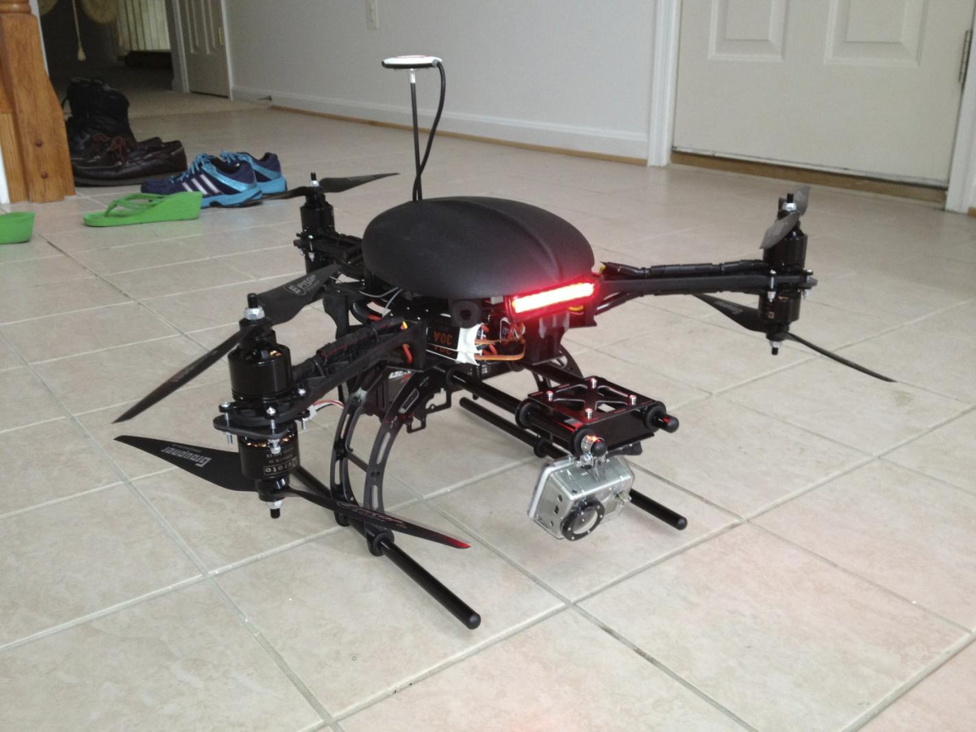

I completed a conversion build of a DJI F550 into a Y6 using Avroto 2814/11s 770 kv motors. I have 11.5 inch Graupners, 30 amp esc, and run two 6000 3s lipos for approximately 9-11 minutes of flight time. That includes a Gopro Hero 2 with casing. I thought the 11 inch Graupners would be too much for my craft, but it flies smooth. I just need to adjust the gains so that it's not so snappy (want smoother transitions for video).
I'm thinking about putting 12 inch Graupners on top and keeping 11 inch on the bottom, but right now, my craft flies fine.
I'll post a video once I get enough video to post online. View attachment 6326View attachment 6327
