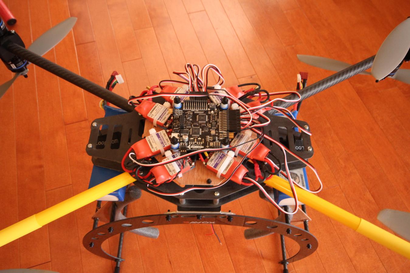

Just went out and had my first flight with a Hoverfly product and I was very pleasantly surprised. My experience is mostly with Mikrokopter but I've also spent a decent amount of time with a suicidal XAircraft X650 and even less time with an OpenPilot Copter Control guided quad. Compared to the XAircraft flight qualitites the Hoverfly is a rock star. The Hoverfly board is also better than the Mikrokopter was with the I2c to PWM converter (the device that lets you use Chinese ESC's or CheeSC's as I like to call them). Is it better, or even as good as, the Mikrokopter flight control system with a full complement of MK motor controllers? That remains to be seen but after one flight it makes me a happy guy to already see that it's a stable flight controller with no obvious wobbles or suicidal thoughts.
Obivously better than the Mikrokopter is the quality of the board and the layout of the components. Granted the HF board is slightly bigger but it's very professional looking in its layout and quality of manufacture. Some of the Mikrokopter boards have been looking pretty rough lately.
We're off to look at bringing home a puppy friend for our 3 yr old Lab Retriever. I've got to organize the wires and later on I'll try to do some more flying and get to know things better. Tonight I'll put my camera mount on and try to get that dialed in for some trials tomorrow but so far so good. I guess they can take the line out of the manual that says the frame has to have a symmetrical arrangement of the motors!
