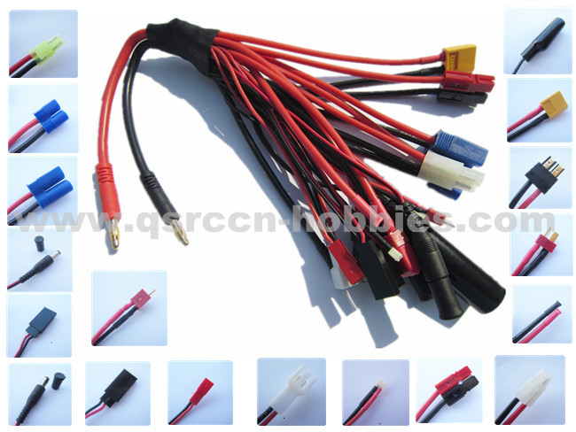

Yep I have down to 3 - Servo, JST, and for the big stuff EC5. Then 2 of these just to be sure I can charge anything
