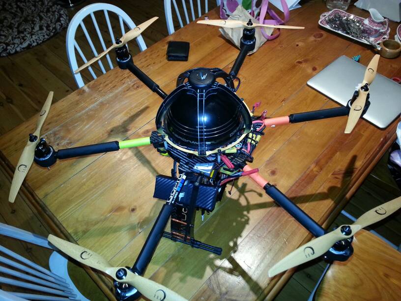

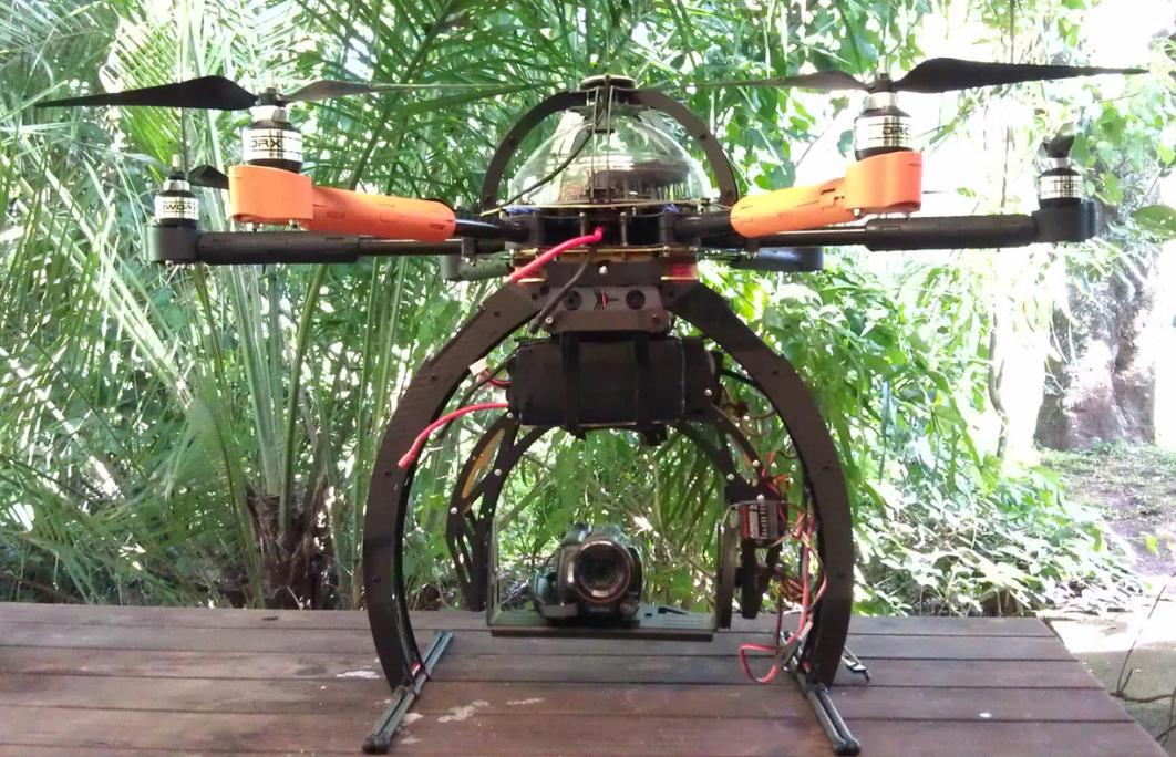

Although it looks much like any other XM6 - here is a pic for anyone interested
nicwilke
Looks great.
I'm flying the XM-6 also View attachment 9135
Its a good rig. I suggest if you are using a light camera, throw in the yellow vibration rubbers, as they seem better for small cams.
I've tried a heap of props on mine, and think APC 12x3.8's to be the best. I am trying Xoar 12x5's and I need to dial out a wobble I get under hard throttle. I'm running a ZeroTech YS - X6 16 waypoints and data link on mine. Would be glad to trade notes.

Your rig looks very tidy indeed.. hope to get mine a bit closer to that once I have finished tinkering.
I would have used the yellow tabs - but as I am running on a single lipo I have put it on the front of the AV200 - as that is as close to the COG as I can get - so the extra 800g makes the red tabs necessary.
I haven't had the luxury of testing other props on my rig, but have found graupners to be good in the past, I do use Xoars on my Skyjib, and can't help but notice and like the use of the aluminium washers on yours.
happy to trade notes - do you mind if I start by asking what your AUW is and what batteries you are running?
