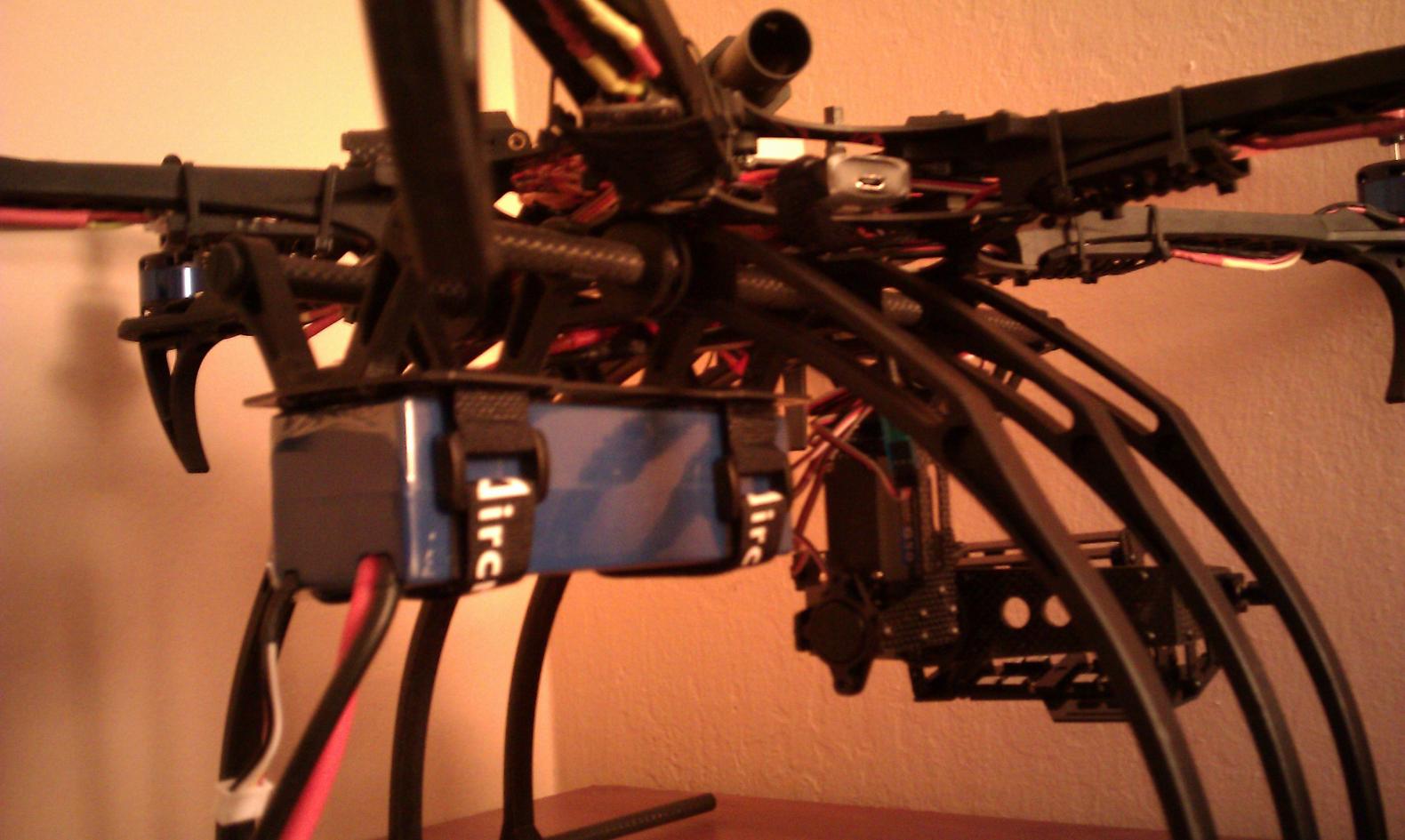

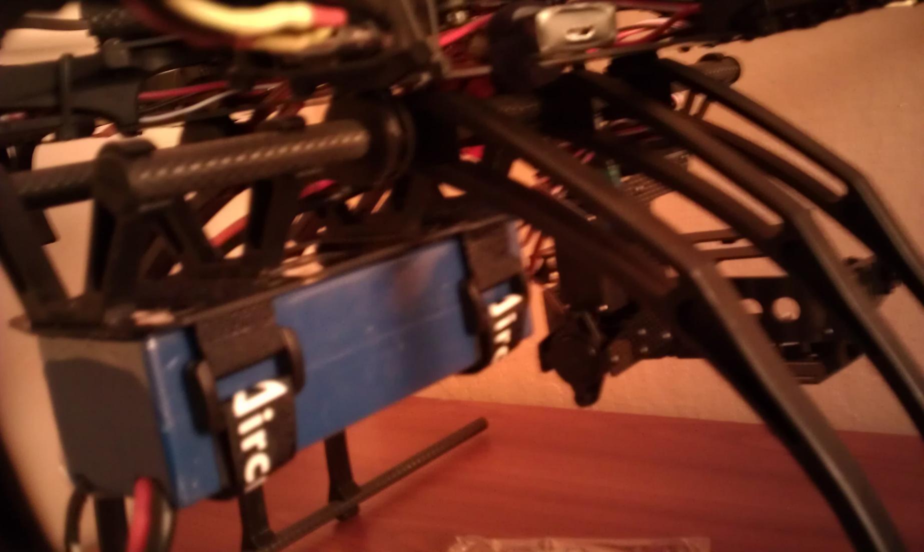

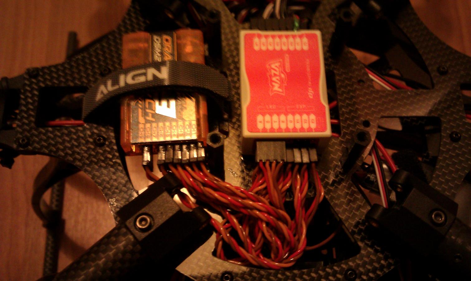

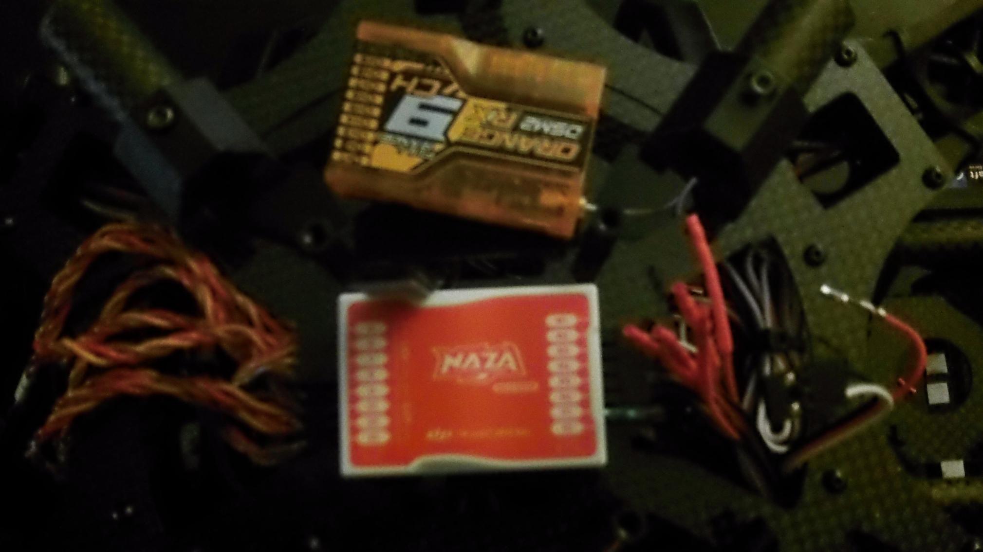

Hello everyone,
I'm still a beginner.I builded for my xaircraft Hexa with Naza,Ake 12A ESC, Lipo 3S 5000MAh. I have to be very gentle on the sticks JR 9303. Increase from midstick to climb, and decrease from midstick to descend so very boost :nevreness:. There is no adjust to control speed in program. ESC mode normal. Should I have to recalibrate each esc again?
Any help would be greatly appreciated.

First off, are you in normal or attitude mode when flying?
Normal can be twitchy, so if you were, try it in attitude.
12A esc's sounds awful small, what motors are you using? I take it you calibrated them once, what are your settings?

Ok, all you have done it to let the esc know the high and low end point. What you need to do next is to program the esc's.
To do this, you will either need a program card from your esc manufacturer or help from somebody since you can not hear the beeps.
If you did not recieve an instruction sheet with the ecs's, you can go on-line and find it. Study it well.
Basically, you will need to plug the red wire back into the connectors, and disconnect all but one motor so whomever helps you out can concentrate on just listening to one motor beep. Make sure the live motor does not have a prop attached.
You will then plug the connector directly into the throttle port of your reciever. Turn on your transmitter with the throttle stick at the high setting, then connect the main battery.
The esc will give off it's initial beeps, normally a 3 beep of different tones, meaning it is armed, the a 3 beep of the same tone, meaning is recognises a 3 cell battery, or 4 is using 4s.
Next will be a pause of a few seconds the several beeps, meaning it is in program mode.
Normally, there are 8 steps to programming. For step 1, there will be a single short beep, a pause, then it will beep again for the first setting of that step, a short pause, a 2 beep tone for the second setting of that step, a short pause, and a 3 beep tone for the 3rd setting of that step.
To select which step to enter, just pull the stick down, wait for the confirming beep and then move the stick back up.
After you move the stick back up, there will then be 2 short beeps, meaning it is now in the second step, followed by a pause, then beeps for each setting point of that step, just like above.
When you get to step 5 of the programming, then the beeps change, usually. Such as a short beep, followed by a longer beep, meaning it is in step 5. This is why it is important to read the set-up instructions.
Finally, when you get to the last step of the programming, this is the exit. It is important finish the last programming step or it will not save your programming.
The only things you really need to change are the battery step, set it to NiCd, and the motor timing, set it to medium.
Once you know how to understand the beep sequence it is really easy to do and saves you money.
When done, don't forget to remove your red wire before plugging the esc back into your Naza and remember to double check your motor rotation when all done.
The motor will not spin when programming, but make sure that the props are removed, as it will when the exit is completed and you bring the stick back down and up again.
Hope this helps you.
p.s. I just checked out your motors, they have a continuous current of 16 amps, so your esc's are small. You will probably get by as long as you don't throw the throttle stick to high position, but you really ought to plan on replacing them as the last thing you want them to do is shut down in flight.
Personally, i go larger than the motor rating, so the esc can never get over-loaded. The harder an esc works, the more heat it generates, and heat is never a good thing.

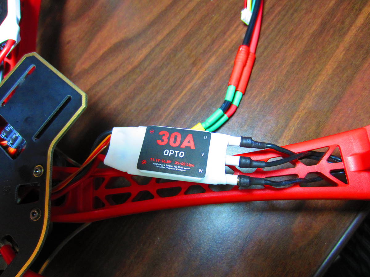

Im planning to get DJI ESC 30A later. I have 8 of Brushless NTM prop drive
Series 28-30A 750kv/140W from hobbyking. Is it good?

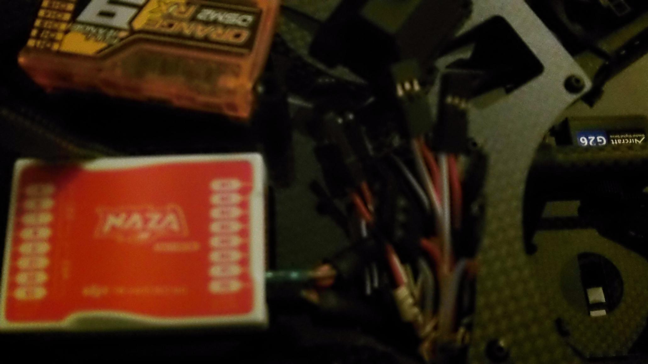

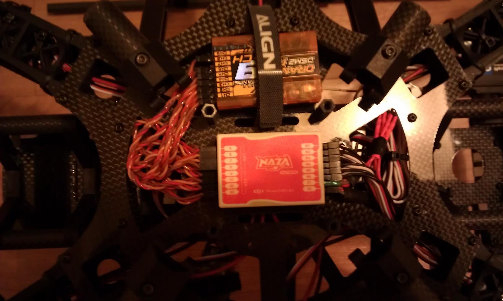

Two weeks ago I used same TX JR 9303 and different spektrum receiver to set up on esc know for
the high and low end point but a few days ago I received new receiver Orange-RX. Does it recalibrate again?
Today I recently removed whole wires from Naza. I plugs the 6 red wire back into the connectors
Step 1...Should I do recalibrate again?
plug the connector into the throttle port of receiver then Turn on TX with the throttle stick
up at connect the main battery then takes 2-5 seconds after move to low throttle and beeps
2- 5 seconds then disconnected battery then next step 2?
I will pick program card up at my friend's place by tmrw
Step 2....
main battery,and ESC plug the connector to program card then 3S lipo to esc
set program card
1 brake- off
2 Battery type - Nicad
3 Cut off type soft cut
4 cut off voltage Low
5 start mode soft
6 Timing mode (Middle)
7 music
8 govener mode OFF

Damn it.... about Your Tiger Motor Plenty of Power . One month ago I got Motors from kinghobby. Which one good for DJI Esc 30a or Tiger 30A?
Any advice Thanks

Thank you!!! very much appreciated. I've done set program card but went so very well. Naza is still on the default for Basic and Attitude. Need more adjustments in the Naza trim Basic Gain, Attitude Gain.
