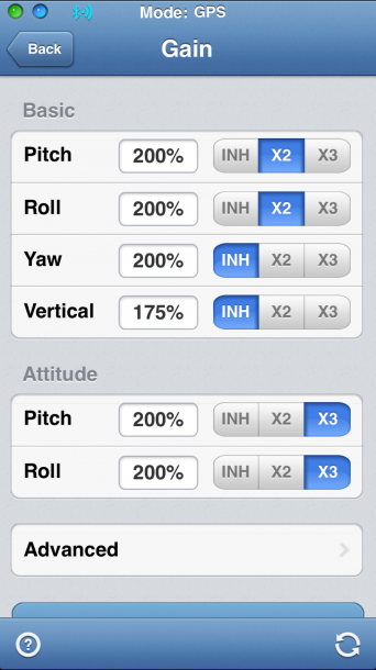

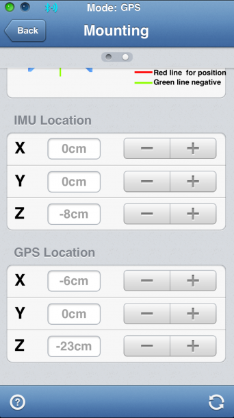

See pics for Gains etc.

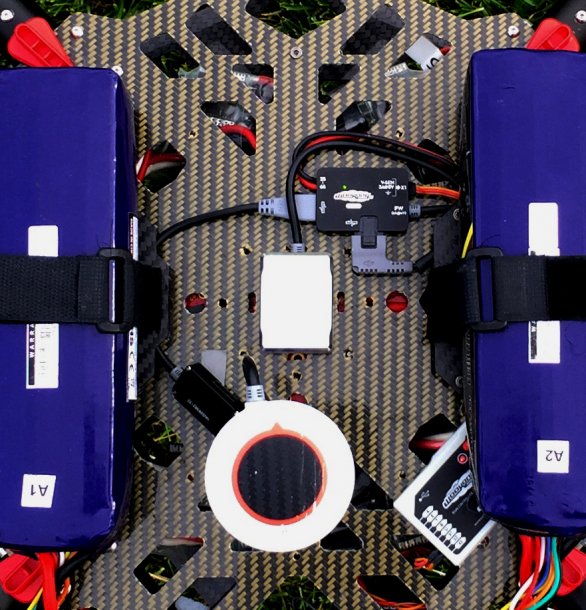

Then someone told me to try the V2 wookong setup for a HL. So I did. I got the Wookong with the new V2 imu. So far it will NOT respond to any commands once airborne, except for throttle.
That being said, ON the ground, and with no blades, It will respond fine. all motors respond correctly ,and follow my movements through all aspects: alt, pitch, roll, elev...
We tried the gains low like 150, we tried them high like 250, NO change.
What could be up? At first I thought it was Gains, they needed to be cranked. They seemed to act super sloppy, and as you can see, it even seems like CG is way off, or gains are super low. But they aren't. The fact that it will NOT respond to any input except throttle is the key I think here. Please pitch in. And thanks.
