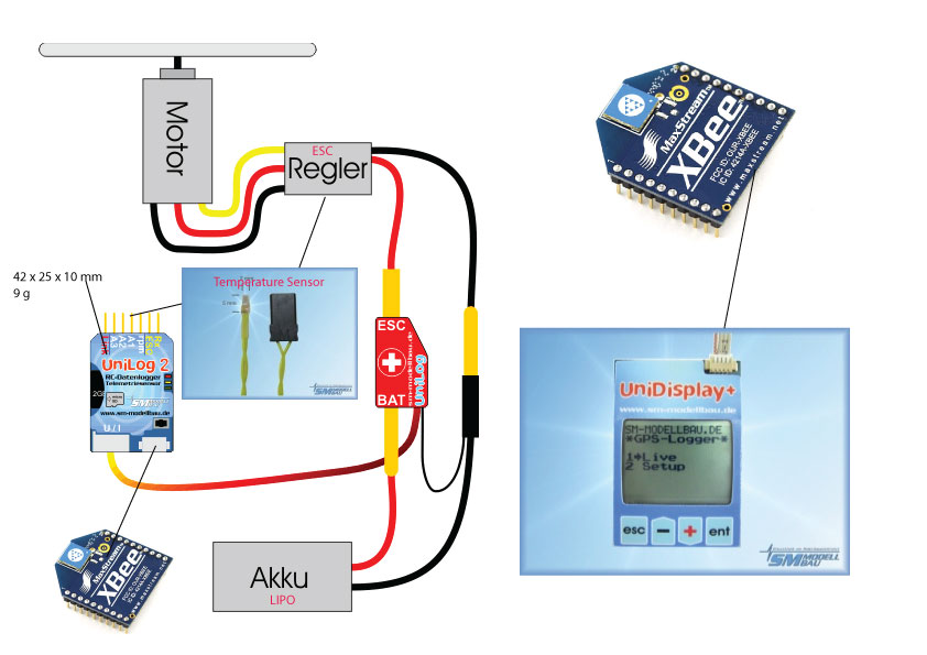

Is it possible to use a Jeti reciever on the WKM with external sensor
To have some Telemetriedata?
I would like to know how much mAH are already used.
Jochen
BorisS
Hi Jochen,
nope no way at the moment. The only way would be a work around with a separate sensor setup, like I will be doing once the parts arrive.
I dont think it would be a big deal for DJI to open up to Jeti but i guess they want to keep it a closed system and sell only their components and
since Futaba don't offer a tele downlink at the moment it fits their strategy

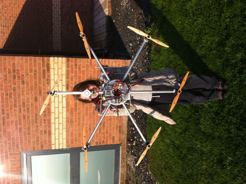

I've just got the following JETI 2.4Ghz Duplex EX system working with V5.12 of the Wookong-M:
- PPM out from the SAT1 pin of the R10 Rx (8 Channels). R9 no good.
- a satellite Rx (RSAT) inputting PPM to the R10 with morse code failure alarm mapped to custom voice alarm
- FAILSAFE working for Wookong-M
Not easy to do, and the Smart Box Profi is essential together with the DC-16 TX's receiver output monitor (under the System menu)
